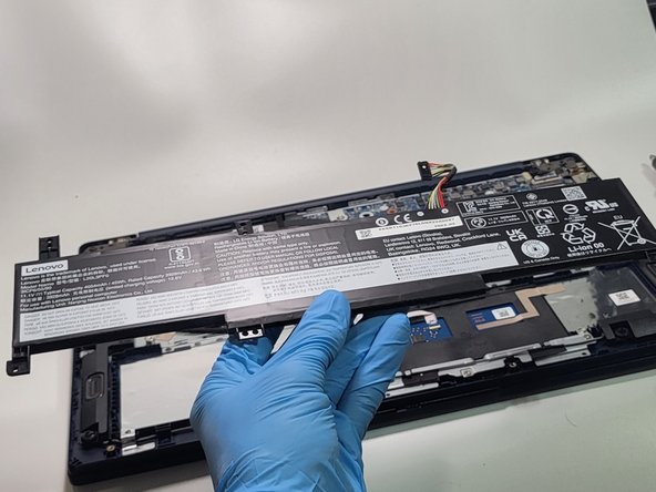

  4. Full teardown. Lenovo IdeaPad 3-15IAU7 Lenovo IdeaPad 3-15IAU7, disconnect the battery: crwdns2935265:04crwdnd2935265:01crwdnd2935265:02crwdne2935265:0 Full teardown. Lenovo IdeaPad 3-15IAU7 Lenovo IdeaPad 3-15IAU7, disconnect the battery: crwdns2935265:04crwdnd2935265:02crwdnd2935265:02crwdne2935265:0
    • disconnect the battery before proceeding

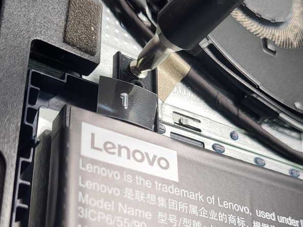

  5. Full teardown. Lenovo IdeaPad 3-15IAU7 Lenovo IdeaPad 3-15IAU7: crwdns2935265:05crwdnd2935265:01crwdnd2935265:03crwdne2935265:0 Full teardown. Lenovo IdeaPad 3-15IAU7 Lenovo IdeaPad 3-15IAU7: crwdns2935265:05crwdnd2935265:02crwdnd2935265:03crwdne2935265:0 Full teardown. Lenovo IdeaPad 3-15IAU7 Lenovo IdeaPad 3-15IAU7: crwdns2935265:05crwdnd2935265:03crwdnd2935265:03crwdne2935265:0
    • remove the 8 ph#1 bit screws from the battery
    • set the battery aside

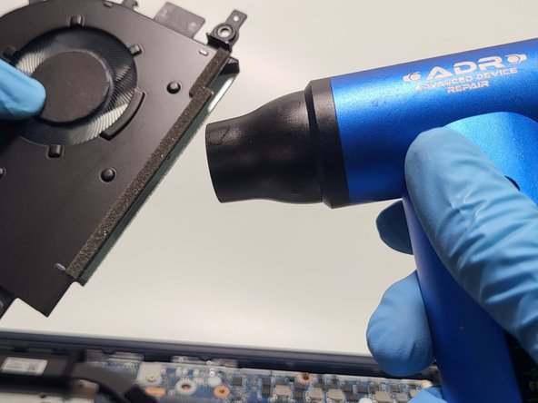

  10. Full teardown. Lenovo IdeaPad 3-15IAU7 Lenovo IdeaPad 3-15IAU7, cooler fan: crwdns2935265:010crwdnd2935265:01crwdnd2935265:03crwdne2935265:0 Full teardown. Lenovo IdeaPad 3-15IAU7 Lenovo IdeaPad 3-15IAU7, cooler fan: crwdns2935265:010crwdnd2935265:02crwdnd2935265:03crwdne2935265:0 Full teardown. Lenovo IdeaPad 3-15IAU7 Lenovo IdeaPad 3-15IAU7, cooler fan: crwdns2935265:010crwdnd2935265:03crwdnd2935265:03crwdne2935265:0
    • unplug the fan connector
    • unscrew 3 ph1 screws from the fan assembly
    • gently pry away the blower fan
  11. Full teardown. Lenovo IdeaPad 3-15IAU7 Lenovo IdeaPad 3-15IAU7, practice good maintenance: crwdns2935265:011crwdnd2935265:01crwdnd2935265:02crwdne2935265:0 Full teardown. Lenovo IdeaPad 3-15IAU7 Lenovo IdeaPad 3-15IAU7, practice good maintenance: crwdns2935265:011crwdnd2935265:02crwdnd2935265:02crwdne2935265:0
    • you got that sucker out clean it up real good.

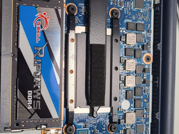

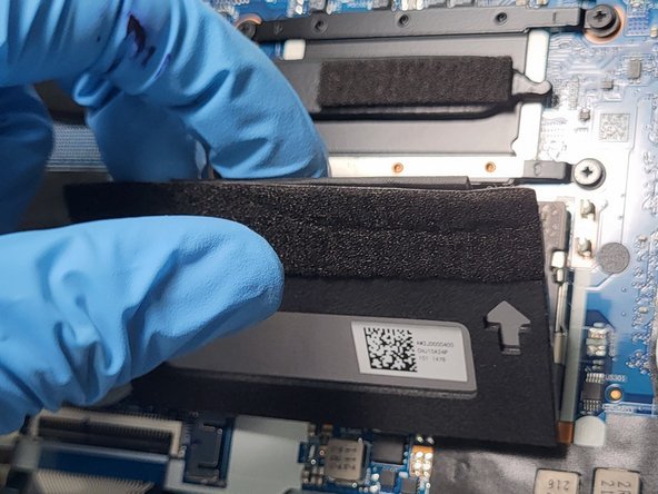

  12. Full teardown. Lenovo IdeaPad 3-15IAU7 Lenovo IdeaPad 3-15IAU7, ram removal: crwdns2935265:012crwdnd2935265:01crwdnd2935265:03crwdne2935265:0 Full teardown. Lenovo IdeaPad 3-15IAU7 Lenovo IdeaPad 3-15IAU7, ram removal: crwdns2935265:012crwdnd2935265:02crwdnd2935265:03crwdne2935265:0 Full teardown. Lenovo IdeaPad 3-15IAU7 Lenovo IdeaPad 3-15IAU7, ram removal: crwdns2935265:012crwdnd2935265:03crwdnd2935265:03crwdne2935265:0
    • remove the ram cover sticker
    • the next parts of this step are optional
    • remove dram

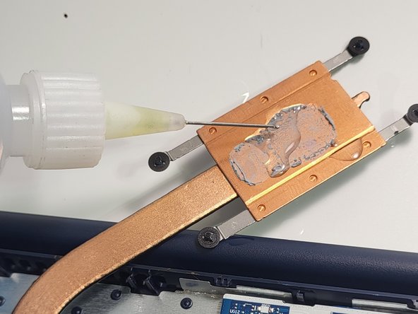

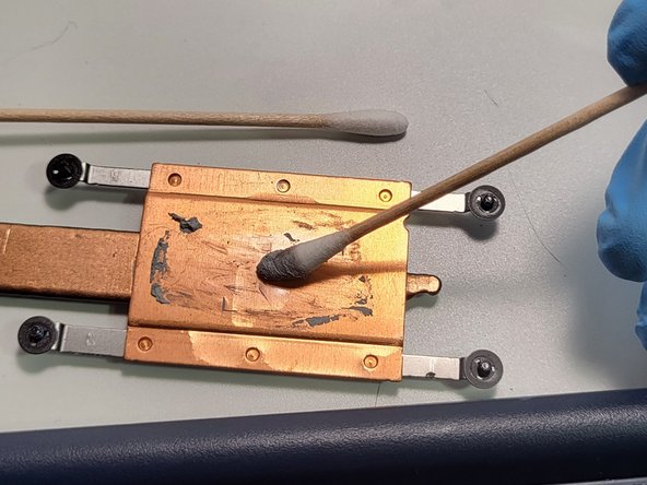

  14. Full teardown. Lenovo IdeaPad 3-15IAU7 Lenovo IdeaPad 3-15IAU7: crwdns2935265:014crwdnd2935265:01crwdnd2935265:03crwdne2935265:0 Full teardown. Lenovo IdeaPad 3-15IAU7 Lenovo IdeaPad 3-15IAU7: crwdns2935265:014crwdnd2935265:02crwdnd2935265:03crwdne2935265:0 Full teardown. Lenovo IdeaPad 3-15IAU7 Lenovo IdeaPad 3-15IAU7: crwdns2935265:014crwdnd2935265:03crwdnd2935265:03crwdne2935265:0
    • clean off the thermal paste with 99% isopropyl alcohol & a q tip
