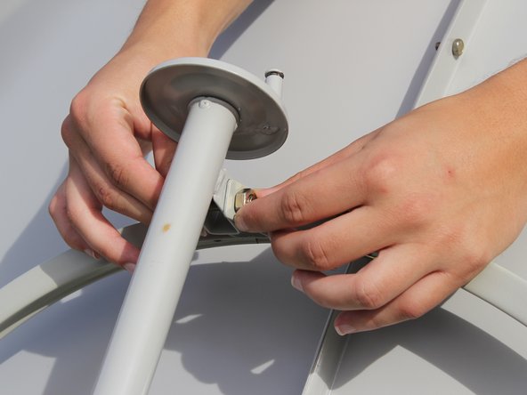

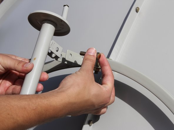

  12. Full Solar Cooker Assembly: crwdns2935265:012crwdnd2935265:01crwdnd2935265:03crwdne2935265:0 Full Solar Cooker Assembly: crwdns2935265:012crwdnd2935265:02crwdnd2935265:03crwdne2935265:0 Full Solar Cooker Assembly: crwdns2935265:012crwdnd2935265:03crwdnd2935265:03crwdne2935265:0
    • Slide the cross bearer into the two holes in the support ring making sure the top of the cross sticks through the center of the solar panel dish.
    • Insert a 14mm bolt into the metal bracket on the support ring through the adjustable arm and secure with a nut.
    • Tighten with your hands.
