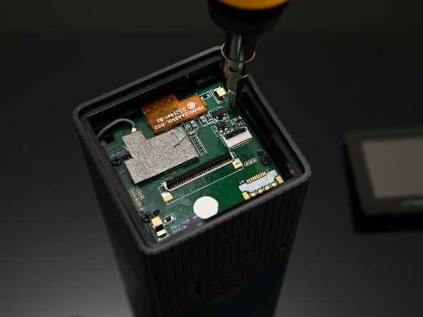

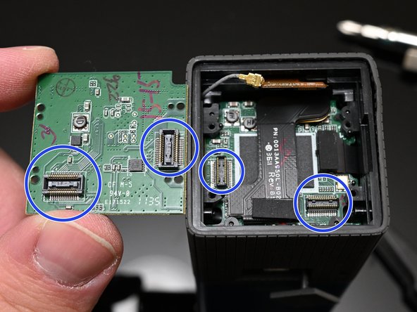

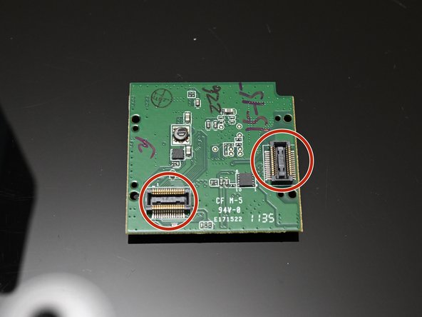

  3. Full Lytro First Generation Teardown (The Easy Way), Unscrew the Interface Board: crwdns2935265:03crwdnd2935265:01crwdnd2935265:02crwdne2935265:0 Full Lytro First Generation Teardown (The Easy Way), Unscrew the Interface Board: crwdns2935265:03crwdnd2935265:02crwdnd2935265:02crwdne2935265:0
    • Remove the four screws which hold this board in.

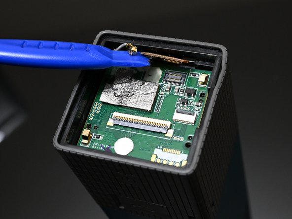

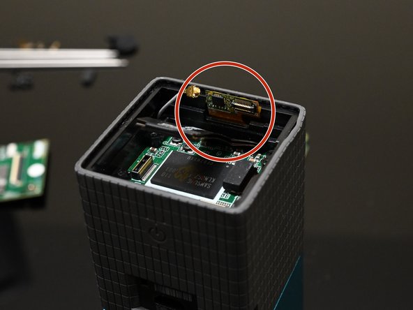

  4. Full Lytro First Generation Teardown (The Easy Way), Disconnect Peripherals: crwdns2935265:04crwdnd2935265:01crwdnd2935265:02crwdne2935265:0 Full Lytro First Generation Teardown (The Easy Way), Disconnect Peripherals: crwdns2935265:04crwdnd2935265:02crwdnd2935265:02crwdne2935265:0
    • Remove the antenna cable. This is covered with conductive tape which you will need to partially peel away.
    • Remove the zoom control ribbon cable. This one is just snapped into a connector on the board. Gentle prying will remove it.
  5. Full Lytro First Generation Teardown (The Easy Way), Remove the Interface Board: crwdns2935265:05crwdnd2935265:01crwdnd2935265:02crwdne2935265:0 Full Lytro First Generation Teardown (The Easy Way), Remove the Interface Board: crwdns2935265:05crwdnd2935265:02crwdnd2935265:02crwdne2935265:0
    • Pry the board out.
    • Note that this may require a spudger or a small flat tip screwdriver due to the board-to-board interconnects on the back.

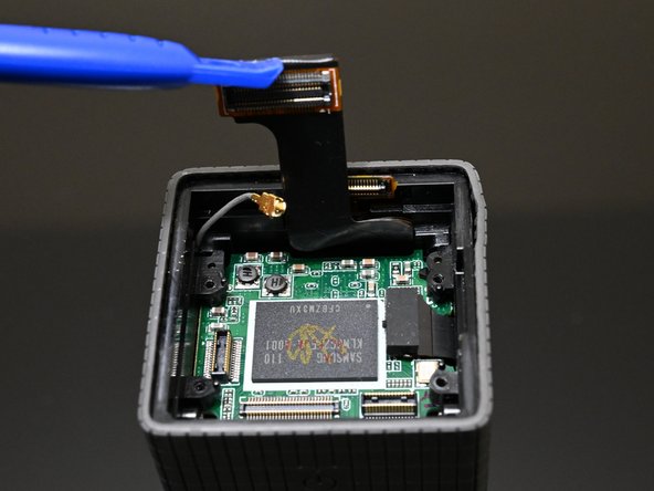

  6. Full Lytro First Generation Teardown (The Easy Way), Disconnect the Lens/Sensor Cable: crwdns2935265:06crwdnd2935265:01crwdnd2935265:02crwdne2935265:0 Full Lytro First Generation Teardown (The Easy Way), Disconnect the Lens/Sensor Cable: crwdns2935265:06crwdnd2935265:02crwdnd2935265:02crwdne2935265:0
    • Disconnect the ribbon cable for the lens/sensor assembly.
    • This ribbon cable is snapped into a connector on the board as well. Just apply a little leverage and it should come loose.

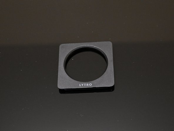

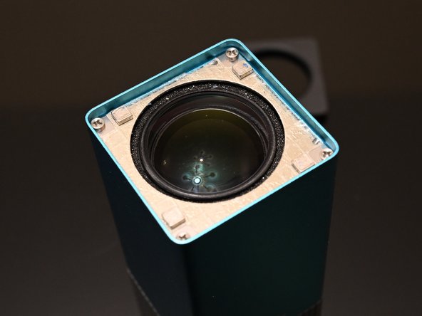

  7. Full Lytro First Generation Teardown (The Easy Way), Remove the Lens Trim: crwdns2935265:07crwdnd2935265:01crwdnd2935265:03crwdne2935265:0 Full Lytro First Generation Teardown (The Easy Way), Remove the Lens Trim: crwdns2935265:07crwdnd2935265:02crwdnd2935265:03crwdne2935265:0 Full Lytro First Generation Teardown (The Easy Way), Remove the Lens Trim: crwdns2935265:07crwdnd2935265:03crwdnd2935265:03crwdne2935265:0
    • Flip the camera upside down. We need to work on the lens side now.
    • Insert a spudger between the lens and the plastic trim on the front of the camera.
    • This is why we're specifically using a plastic spudger. A metal spudger would scratch the lens badly.
    • Pry up gently to break the adhesive and remove the face plate.

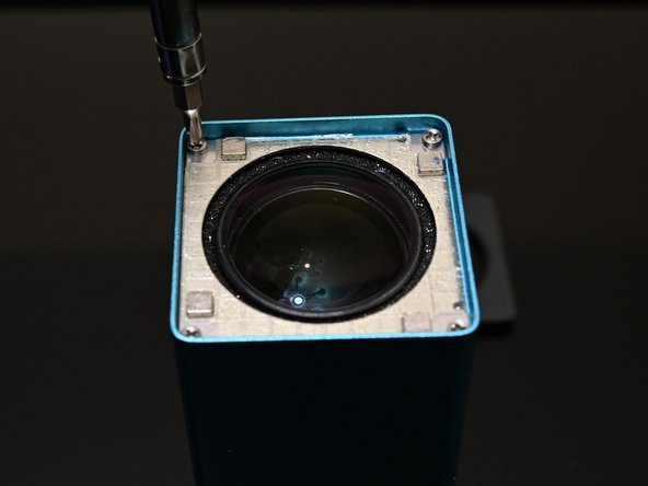

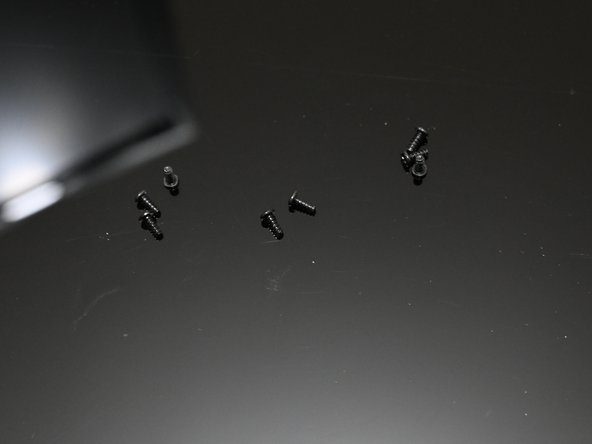

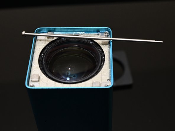

  8. Full Lytro First Generation Teardown (The Easy Way), Remove the Lens Screws: crwdns2935265:08crwdnd2935265:01crwdnd2935265:03crwdne2935265:0 Full Lytro First Generation Teardown (The Easy Way), Remove the Lens Screws: crwdns2935265:08crwdnd2935265:02crwdnd2935265:03crwdne2935265:0 Full Lytro First Generation Teardown (The Easy Way), Remove the Lens Screws: crwdns2935265:08crwdnd2935265:03crwdnd2935265:03crwdne2935265:0
    • Remove the four screws that hold the lens assembly on.
    • Note that these screws are extremely long and fairly unique looking. They're pretty hard to lose, but don't bend them. You'd probably have a hard time finding replacements.

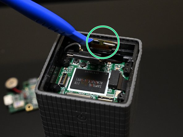

  9. Full Lytro First Generation Teardown (The Easy Way), Open the Camera: crwdns2935265:09crwdnd2935265:01crwdnd2935265:01crwdne2935265:0
    • You can now open the camera by breaking it in half at the seam between the rubberized grip and the anodized lens housing.
    • Note that the ribbon cable for the lens is on the top side of the camera. Treat the top as if it were a hinge and open the camera from the bottom (power button/charge port) side. You should have plenty of slack from disconnecting the other end, but be careful.

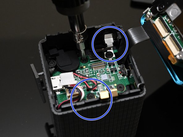

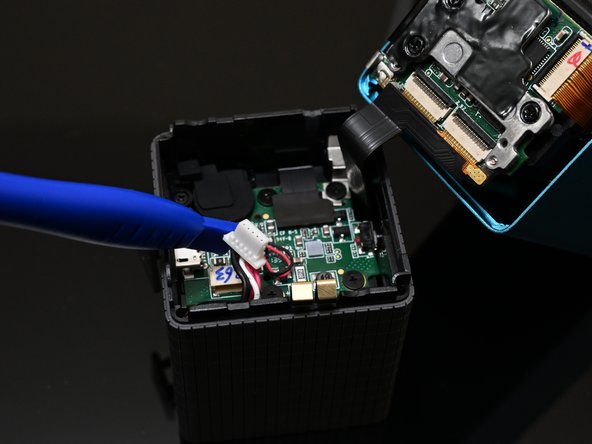

  10. Full Lytro First Generation Teardown (The Easy Way), Disconnect the Battery: crwdns2935265:010crwdnd2935265:01crwdnd2935265:02crwdne2935265:0 Full Lytro First Generation Teardown (The Easy Way), Disconnect the Battery: crwdns2935265:010crwdnd2935265:02crwdnd2935265:02crwdne2935265:0
    • Disconnect the battery.
    • The battery wires are tucked behind the connector from the factory, so you may need to push those aside to gain enough room to pull the connector out.
  11. Full Lytro First Generation Teardown (The Easy Way), Disconnect the Board-to-Board Ribbon Cable: crwdns2935265:011crwdnd2935265:01crwdnd2935265:01crwdne2935265:0
    • Disconnect the ribbon cable in the opposite corner from the battery.
    • There is a double-sided sticky pad under the cable, so you may have to use some force to remove it from the board. The connector itself is just snapped in like the last couple of ribbon cables we disconnected.

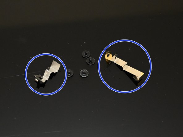

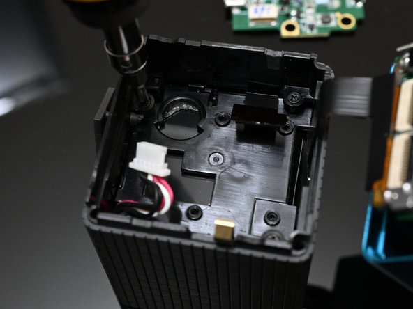

  12. Full Lytro First Generation Teardown (The Easy Way), Unscrew the Board: crwdns2935265:012crwdnd2935265:01crwdnd2935265:03crwdne2935265:0 Full Lytro First Generation Teardown (The Easy Way), Unscrew the Board: crwdns2935265:012crwdnd2935265:02crwdnd2935265:03crwdne2935265:0 Full Lytro First Generation Teardown (The Easy Way), Unscrew the Board: crwdns2935265:012crwdnd2935265:03crwdnd2935265:03crwdne2935265:0
    • Remove the four screws that hold this board in.
    • Pay special attention to the two screws which retain metal... things. One of these is definitely required for proper grounding/RF compliance (not sure about the other). Do not lose these.

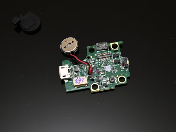

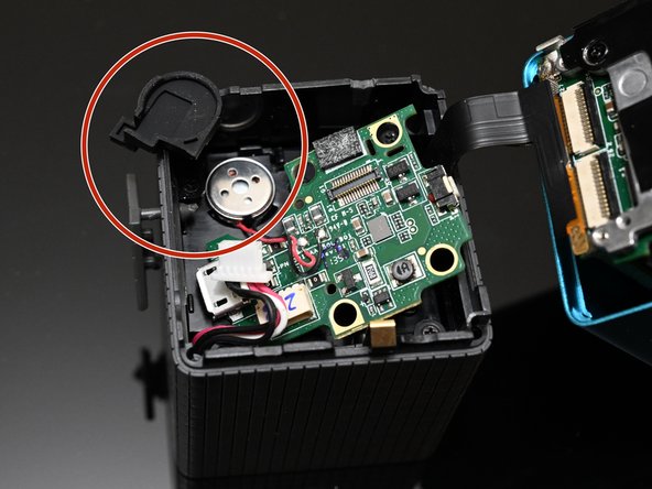

  13. Full Lytro First Generation Teardown (The Easy Way), Remove the Board: crwdns2935265:013crwdnd2935265:01crwdnd2935265:03crwdne2935265:0 Full Lytro First Generation Teardown (The Easy Way), Remove the Board: crwdns2935265:013crwdnd2935265:02crwdnd2935265:03crwdne2935265:0 Full Lytro First Generation Teardown (The Easy Way), Remove the Board: crwdns2935265:013crwdnd2935265:03crwdnd2935265:03crwdne2935265:0
    • Pry the board up gently.
    • Do not remove it completely yet! The speaker wires are thin and delicate!
    • Remove the rubber cap from the speaker.
    • After removing the speaker cap, the speaker is just held in with adhesive and can be gently pried up.
    • Once the speaker is free, you can safely remove the board.

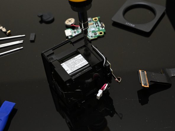

  14. Full Lytro First Generation Teardown (The Easy Way), Unscrew the Battery/CPU Assembly: crwdns2935265:014crwdnd2935265:01crwdnd2935265:03crwdne2935265:0 Full Lytro First Generation Teardown (The Easy Way), Unscrew the Battery/CPU Assembly: crwdns2935265:014crwdnd2935265:02crwdnd2935265:03crwdne2935265:0 Full Lytro First Generation Teardown (The Easy Way), Unscrew the Battery/CPU Assembly: crwdns2935265:014crwdnd2935265:03crwdnd2935265:03crwdne2935265:0
    • Remove the four screws which hold the battery/CPU sub-assembly in.
    • Note that these screws are identical to the ones you removed from the interface board earlier. No need to worry about mixing them up.

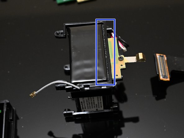

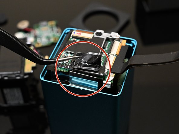

  15. Full Lytro First Generation Teardown (The Easy Way), Remove the Battery/CPU Sub-Assembly: crwdns2935265:015crwdnd2935265:01crwdnd2935265:03crwdne2935265:0 Full Lytro First Generation Teardown (The Easy Way), Remove the Battery/CPU Sub-Assembly: crwdns2935265:015crwdnd2935265:02crwdnd2935265:03crwdne2935265:0 Full Lytro First Generation Teardown (The Easy Way), Remove the Battery/CPU Sub-Assembly: crwdns2935265:015crwdnd2935265:03crwdnd2935265:03crwdne2935265:0
    • Remove the foam pad from the back of the lens/sensor cable.
    • With the foam pad attached, the cable would be too thick to fit through the narrow channel we're about to pull it through.
    • Be careful to watch for how the zoom control ribbon cable and the lens/sensor cable are moving as you push this next sub-assembly out.
    • Push the battery/CPU sub-assembly out gently from the lens side (i.e. toward the screen side) of the camera.
    • If the assembly does not slide freely (and it probably won't) do not force it. The ribbon cables are delicate and you can tear them. Use twezers if you need to, but carefully guide the cables through the holes in the battery/CPU assembly as you push.

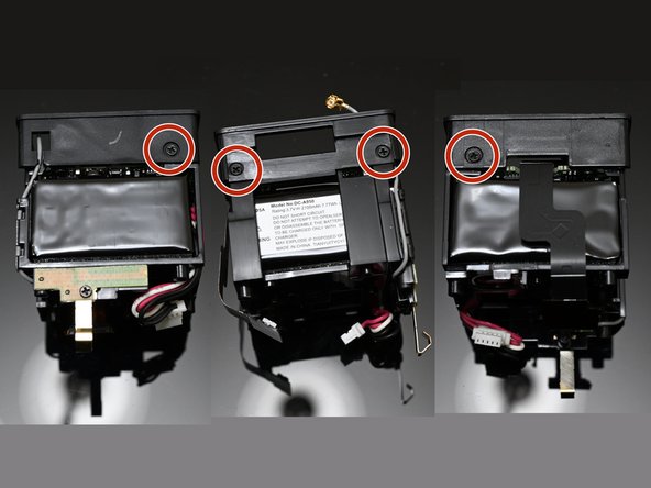

  16. Full Lytro First Generation Teardown (The Easy Way), Separate the CPU Board from the Battery: crwdns2935265:016crwdnd2935265:01crwdnd2935265:03crwdne2935265:0 Full Lytro First Generation Teardown (The Easy Way), Separate the CPU Board from the Battery: crwdns2935265:016crwdnd2935265:02crwdnd2935265:03crwdne2935265:0 Full Lytro First Generation Teardown (The Easy Way), Separate the CPU Board from the Battery: crwdns2935265:016crwdnd2935265:03crwdnd2935265:03crwdne2935265:0
    • After pushing the CPU/Battery assembly out, we need to remove four screws to separate the CPU board from the battery assembly.
    • These screws are on three different sides of the assembly.

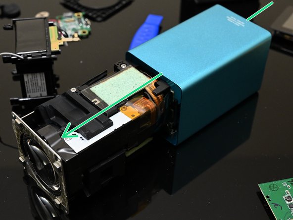

  18. Full Lytro First Generation Teardown (The Easy Way), Remove the Lens Assembly: crwdns2935265:018crwdnd2935265:01crwdnd2935265:03crwdne2935265:0 Full Lytro First Generation Teardown (The Easy Way), Remove the Lens Assembly: crwdns2935265:018crwdnd2935265:02crwdnd2935265:03crwdne2935265:0 Full Lytro First Generation Teardown (The Easy Way), Remove the Lens Assembly: crwdns2935265:018crwdnd2935265:03crwdnd2935265:03crwdne2935265:0
    • At this point, the only thing holding the lens assembly in its housing is a single piece of tape. The adhesive is not strong. Lift it with a pair of tweezers or the like.
    • After the tape is lifted, the lens assembly can be pushed out from the back (from the screen side of the camera).

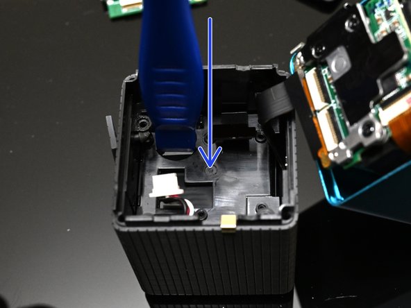

  20. Full Lytro First Generation Teardown (The Easy Way), Reassembly Tips: crwdns2935265:020crwdnd2935265:01crwdnd2935265:03crwdne2935265:0 Full Lytro First Generation Teardown (The Easy Way), Reassembly Tips: crwdns2935265:020crwdnd2935265:02crwdnd2935265:03crwdne2935265:0 Full Lytro First Generation Teardown (The Easy Way), Reassembly Tips: crwdns2935265:020crwdnd2935265:03crwdnd2935265:03crwdne2935265:0
    • The zoom control ribbon cable is tricky to get back in position. It needs to be threaded through a hole in the battery/CPU sub-assembly housing.
    • Start with the cable on the outside of the housing, then tuck it through the hole pointed to by the red arrow.
    • After tucking it into the hole, the cable should be poking out underneath the plastic support pointed to by the green arrow.
    • Be mindful of the board-to-board interconnects when replacing the interface board. There are plastic pins which help align the board, and the screws should apply enough pressure to snap the connection together, but you may want to make sure that they're together by pressing gently behind the connectors until you hear them click.
