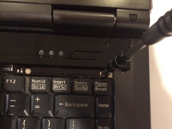

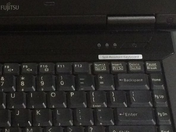

    1. Fujtsu Lifebook Model A6110 Keyboard Replacement, Keyboard: crwdns2935265:03crwdnd2935265:01crwdnd2935265:03crwdne2935265:0 Fujtsu Lifebook Model A6110 Keyboard Replacement, Keyboard: crwdns2935265:03crwdnd2935265:02crwdnd2935265:03crwdne2935265:0 Fujtsu Lifebook Model A6110 Keyboard Replacement, Keyboard: crwdns2935265:03crwdnd2935265:03crwdnd2935265:03crwdne2935265:0
      • Position the laptop like you would if you were to use it. Open the screen to a 180 degrees angle. The screen and the keyboard needs to face up before proceeding.
      • Using a flat edge of the plastic spudger, gently lift the piece of plastic located in the red square. Carefully insert the spudger between the inner edge marked by the arrow.
    2. Fujtsu Lifebook Model A6110 Keyboard Replacement: crwdns2935265:04crwdnd2935265:01crwdnd2935265:03crwdne2935265:0 Fujtsu Lifebook Model A6110 Keyboard Replacement: crwdns2935265:04crwdnd2935265:02crwdnd2935265:03crwdne2935265:0 Fujtsu Lifebook Model A6110 Keyboard Replacement: crwdns2935265:04crwdnd2935265:03crwdnd2935265:03crwdne2935265:0
      • With a Phillips #1 screwdriver, unscrew the four-six mm screws that were hidden under the plastic piece you removed.

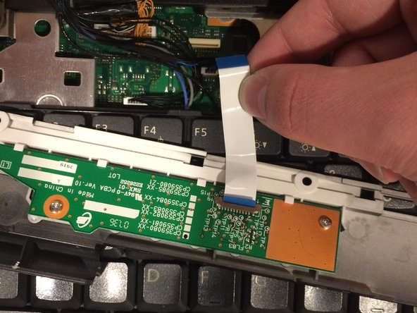

    3. Fujtsu Lifebook Model A6110 Keyboard Replacement: crwdns2935265:05crwdnd2935265:01crwdnd2935265:03crwdne2935265:0 Fujtsu Lifebook Model A6110 Keyboard Replacement: crwdns2935265:05crwdnd2935265:02crwdnd2935265:03crwdne2935265:0 Fujtsu Lifebook Model A6110 Keyboard Replacement: crwdns2935265:05crwdnd2935265:03crwdnd2935265:03crwdne2935265:0
      • Lift up on the inner edges of the hinges for the screen. This will detach the face-plate from the computer. Use a spudger to make this process easier.
      • There is a ribbon underneath this panel that attaches to the motherboard. Be careful to not rip this ribbon.
      • The ribbon is located in the top left-hand corner and needs to carefully disconnected from the motherboard, as shown in the next step.
    4. Fujtsu Lifebook Model A6110 Keyboard Replacement: crwdns2935265:06crwdnd2935265:01crwdnd2935265:02crwdne2935265:0 Fujtsu Lifebook Model A6110 Keyboard Replacement: crwdns2935265:06crwdnd2935265:02crwdnd2935265:02crwdne2935265:0
      • Detach the ribbon from the motherboard, which will allow you to finish removing the face-plate from the computer.
      • To detach the ribbon, grip the ribbon at the base that is attached to the motherboard, which is the large green circuit-board in the body of the computer.
      • When reassembling the computer, make sure to reconnect the ribbons.

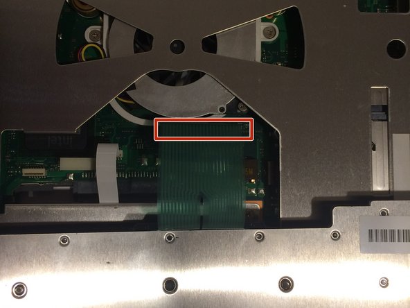

    5. Fujtsu Lifebook Model A6110 Keyboard Replacement: crwdns2935265:07crwdnd2935265:01crwdnd2935265:02crwdne2935265:0 Fujtsu Lifebook Model A6110 Keyboard Replacement: crwdns2935265:07crwdnd2935265:02crwdnd2935265:02crwdne2935265:0
      • There is another ribbon connecting the keyboard to the motherboard. Be careful not to rip it
      • The keyboard is now free. Lift up on the keyboard.
    6. Fujtsu Lifebook Model A6110 Keyboard Replacement: crwdns2935265:08crwdnd2935265:01crwdnd2935265:01crwdne2935265:0
      • This ribbon may be difficult to remove, so be careful in pulling it. You could accidentally break it.
      • Detatch the ribbon from the motherboard
      • When reassembling the computer, make sure to reconnect this ribbon.
