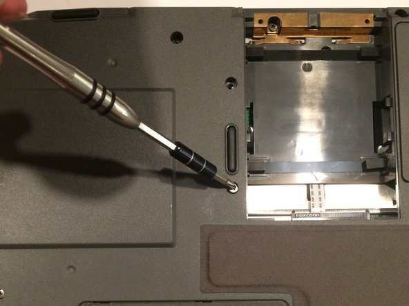

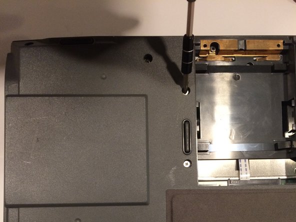

    • The disk drive will be located on the side of the computer, on the top-left corner
    • Using a Phillips #1 screwdriver, remove the two 6 mm screws which are located above the disk drive. Remove the screws by turning your screwdriver counter-clockwise.

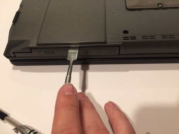

  4. Fujtsu Lifebook Model A6110 Disk Drive Replacement: crwdns2935265:04crwdnd2935265:01crwdnd2935265:02crwdne2935265:0 Fujtsu Lifebook Model A6110 Disk Drive Replacement: crwdns2935265:04crwdnd2935265:02crwdnd2935265:02crwdne2935265:0
    • Insert the metal spudger in the gap between the disk drive and the laptop's body itself, as seen in the picture.
    • Push the spudger down, so that it is behind the drive.
    • Gently pull the disk drive out from the laptop until it unlatches.
  5. Fujtsu Lifebook Model A6110 Disk Drive Replacement: crwdns2935265:05crwdnd2935265:01crwdnd2935265:01crwdne2935265:0
    • Once the disk-drive has been unlatched from its slot, pull it gently from the laptop case.
