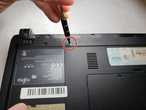

  4. Fujitsu M2011 Hard Drive Replacement, Hard Drive: crwdns2935265:04crwdnd2935265:01crwdnd2935265:02crwdne2935265:0 Fujitsu M2011 Hard Drive Replacement, Hard Drive: crwdns2935265:04crwdnd2935265:02crwdnd2935265:02crwdne2935265:0
    • Remove the two 3 mm PH0 screws holding hard drive in place.
  5. Fujitsu M2011 Hard Drive Replacement: crwdns2935265:05crwdnd2935265:01crwdnd2935265:01crwdne2935265:0
    • Unfold the black tab attached to hard drive.
  6. Fujitsu M2011 Hard Drive Replacement: crwdns2935265:06crwdnd2935265:01crwdnd2935265:01crwdne2935265:0
    • Remove the hard drive by pulling the black tab.
