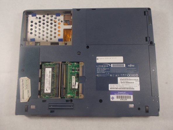

  2. Fujitsu Lifebook S6120 RAM Replacement, RAM: crwdns2935265:02crwdnd2935265:01crwdnd2935265:02crwdne2935265:0 Fujitsu Lifebook S6120 RAM Replacement, RAM: crwdns2935265:02crwdnd2935265:02crwdnd2935265:02crwdne2935265:0
    • Use a Philips head #0 to remove the 4mm screws to the RAM cover.

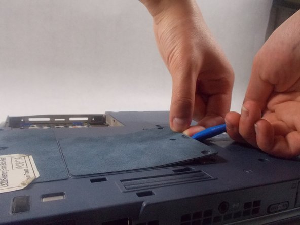

  3. Fujitsu Lifebook S6120 RAM Replacement: crwdns2935265:03crwdnd2935265:01crwdnd2935265:03crwdne2935265:0 Fujitsu Lifebook S6120 RAM Replacement: crwdns2935265:03crwdnd2935265:02crwdnd2935265:03crwdne2935265:0 Fujitsu Lifebook S6120 RAM Replacement: crwdns2935265:03crwdnd2935265:03crwdnd2935265:03crwdne2935265:0
    • Use the plastic opening tool to lift the RAM cover.
    • Use your hands to slide the cover off.
  4. Fujitsu Lifebook S6120 RAM Replacement: crwdns2935265:04crwdnd2935265:01crwdnd2935265:03crwdne2935265:0 Fujitsu Lifebook S6120 RAM Replacement: crwdns2935265:04crwdnd2935265:02crwdnd2935265:03crwdne2935265:0 Fujitsu Lifebook S6120 RAM Replacement: crwdns2935265:04crwdnd2935265:03crwdnd2935265:03crwdne2935265:0
    • Remove RAM module by pushing security clips outward.
    • The RAM module should pop out.
    • Carefully pull RAM module out of the computer.
