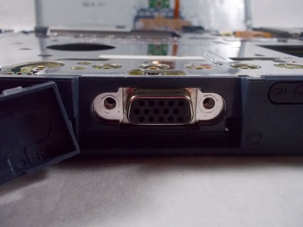

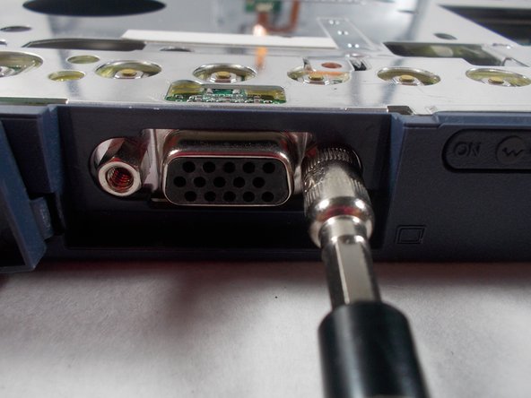

    • Use a 5mm nut driver to unscrew the nuts.
  15. Fujitsu Lifebook S6120 Fan Replacement: crwdns2935265:015crwdnd2935265:01crwdnd2935265:02crwdne2935265:0 Fujitsu Lifebook S6120 Fan Replacement: crwdns2935265:015crwdnd2935265:02crwdnd2935265:02crwdne2935265:0

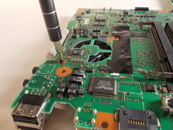

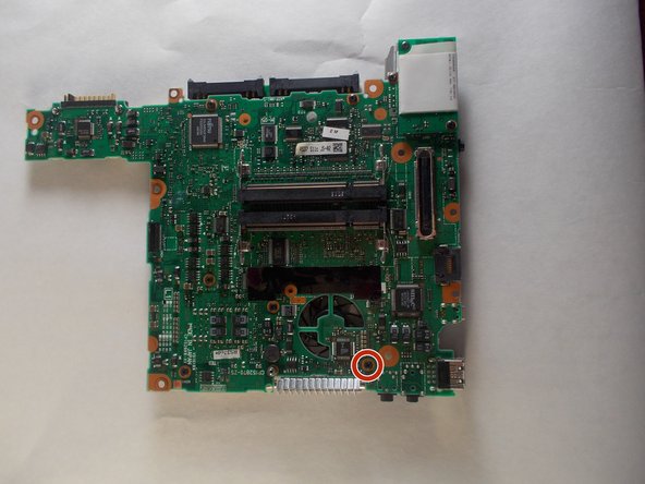

    • Using a Philips head size #0 remove the 3mm screw on the back of the motherboard.
  21. Fujitsu Lifebook S6120 Fan Replacement: crwdns2935265:021crwdnd2935265:01crwdnd2935265:03crwdne2935265:0 Fujitsu Lifebook S6120 Fan Replacement: crwdns2935265:021crwdnd2935265:02crwdnd2935265:03crwdne2935265:0 Fujitsu Lifebook S6120 Fan Replacement: crwdns2935265:021crwdnd2935265:03crwdnd2935265:03crwdne2935265:0
    • Using tweezers detach the cable from the motherboard.
  22. Fujitsu Lifebook S6120 Fan Replacement: crwdns2935265:022crwdnd2935265:01crwdnd2935265:02crwdne2935265:0 Fujitsu Lifebook S6120 Fan Replacement: crwdns2935265:022crwdnd2935265:02crwdnd2935265:02crwdne2935265:0
    • The fan can now be removed from the motherboard.
