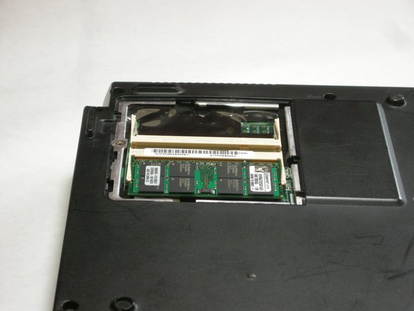

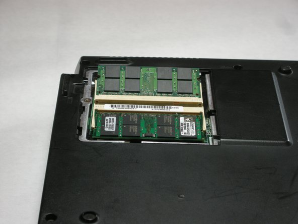

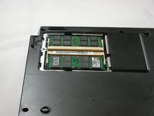

    4. Fujitsu LifeBook N3510 RAM Replacement: crwdns2935265:06crwdnd2935265:01crwdnd2935265:02crwdne2935265:0 Fujitsu LifeBook N3510 RAM Replacement: crwdns2935265:06crwdnd2935265:02crwdnd2935265:02crwdne2935265:0
      • Remove the RAM module by pushing the securing clips outward.
      • The RAM module will then slightly pop out.
      • When you are installing a new RAM module, carefully insert it into the socket and push downwards.
    5. Fujitsu LifeBook N3510 RAM Replacement: crwdns2935265:07crwdnd2935265:01crwdnd2935265:02crwdne2935265:0 Fujitsu LifeBook N3510 RAM Replacement: crwdns2935265:07crwdnd2935265:02crwdnd2935265:02crwdne2935265:0
      • Carefully pull the RAM module from the computer.
