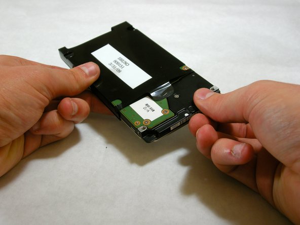

      • Grasp hard drive sleeve tab and pull out.
    4. Fujitsu LifeBook N3510 Hard Drive Replacement: crwdns2935265:06crwdnd2935265:01crwdnd2935265:03crwdne2935265:0 Fujitsu LifeBook N3510 Hard Drive Replacement: crwdns2935265:06crwdnd2935265:02crwdnd2935265:03crwdne2935265:0 Fujitsu LifeBook N3510 Hard Drive Replacement: crwdns2935265:06crwdnd2935265:03crwdnd2935265:03crwdne2935265:0
      • Remove hard drive from plastic sleeve.
