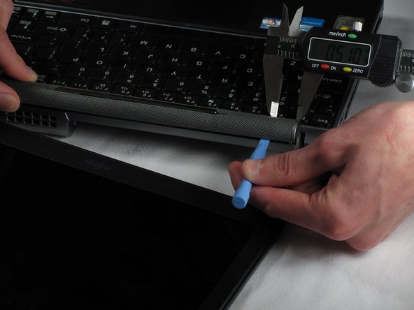

    • Using a smaller spudger (like a PX3688), pivot the sound case out above the "F2" and "Insert" buttons.
    • Lift the case out and set it aside.
    • For the proceeding steps, put on your anti-static wrist strap and attach the metal clip to something metal and grounded in order to protect the delicate circuitry inside the computer.

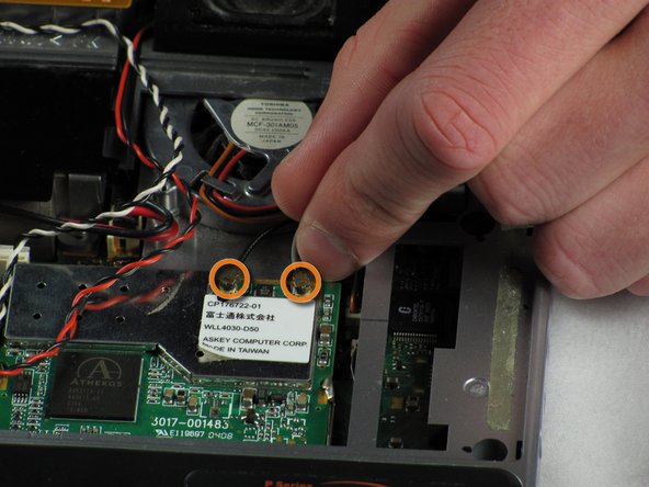

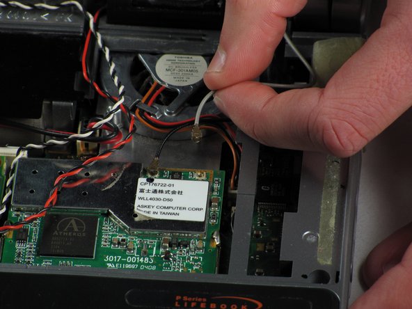

    • Peel the white tape from the wires connected to the monitor, but do not completely remove it.
    • Unplug the white and black wires with your fingers.
  10. Fujitsu LIFEBOOK P7010D Monitor Replacement: crwdns2935265:010crwdnd2935265:01crwdnd2935265:03crwdne2935265:0 Fujitsu LIFEBOOK P7010D Monitor Replacement: crwdns2935265:010crwdnd2935265:02crwdnd2935265:03crwdne2935265:0 Fujitsu LIFEBOOK P7010D Monitor Replacement: crwdns2935265:010crwdnd2935265:03crwdnd2935265:03crwdne2935265:0
    • Unplug the white chip connected to the thicker wire with two smaller spudgers (like a PX3688) by wiggling it back and forth until it pops out.
