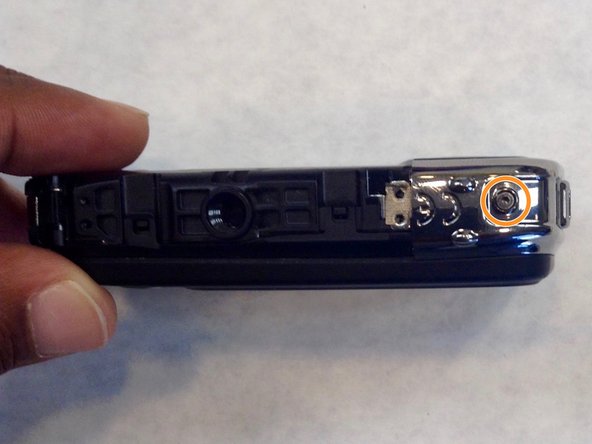

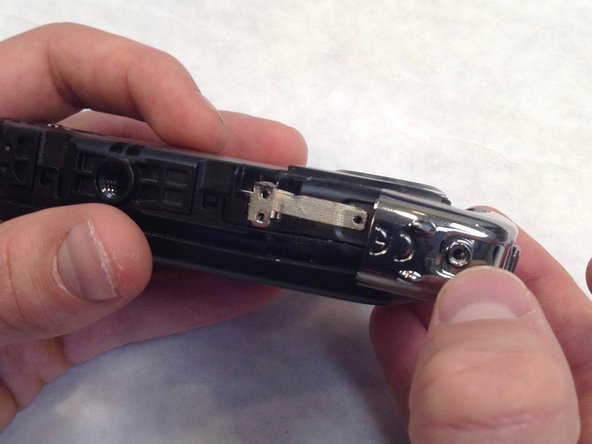

    • Using a 1.5mm Hex screwdriver, remove 3.0 mm hex screw on top edge of silver panel.
    • Using a Phillips #00 screwdriver, remove the 3.0 mm screw on bottom edge.
    • Once both screws are removed the silver side casing will slide off.

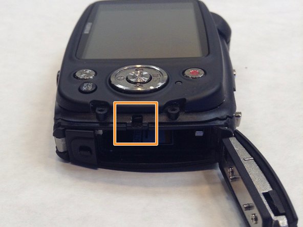

  5. Fujifilm XP20 LCD Screen Replacement: crwdns2935265:05crwdnd2935265:01crwdnd2935265:03crwdne2935265:0 Fujifilm XP20 LCD Screen Replacement: crwdns2935265:05crwdnd2935265:02crwdnd2935265:03crwdne2935265:0 Fujifilm XP20 LCD Screen Replacement: crwdns2935265:05crwdnd2935265:03crwdnd2935265:03crwdne2935265:0
    • Unlatch the four clasps located on each side of the camera by hand.
    • The fourth clasp is concealed by the battery door. To reach the clasp see Fujifilm XP20 Battery Replacement for instructions.

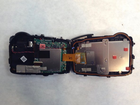

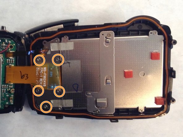

  6. Fujifilm XP20 LCD Screen Replacement: crwdns2935265:06crwdnd2935265:01crwdnd2935265:03crwdne2935265:0 Fujifilm XP20 LCD Screen Replacement: crwdns2935265:06crwdnd2935265:02crwdnd2935265:03crwdne2935265:0 Fujifilm XP20 LCD Screen Replacement: crwdns2935265:06crwdnd2935265:03crwdnd2935265:03crwdne2935265:0
    • Using a Phillips #00 screwdriver, remove the seven 3.0 mm screws.
    • Remove the remaining five 3.0 mm screws which hold the rear case and the control panel together.
    • The rear panel is now free from the camera.

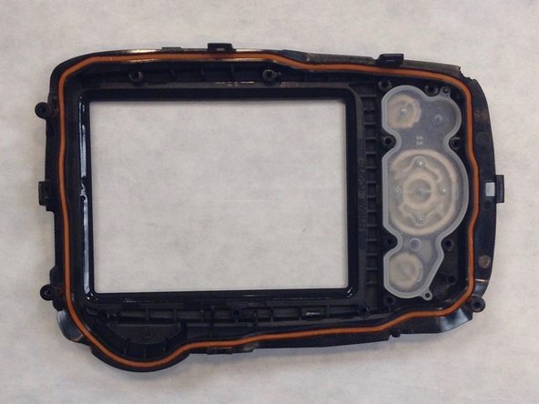

  7. Fujifilm XP20 LCD Screen Replacement: crwdns2935265:07crwdnd2935265:01crwdnd2935265:03crwdne2935265:0 Fujifilm XP20 LCD Screen Replacement: crwdns2935265:07crwdnd2935265:02crwdnd2935265:03crwdne2935265:0 Fujifilm XP20 LCD Screen Replacement: crwdns2935265:07crwdnd2935265:03crwdnd2935265:03crwdne2935265:0

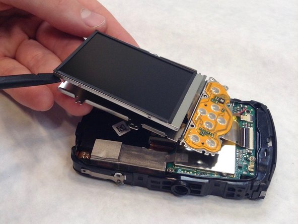

    • Take the spudger and wedge it in between the screen and the frame.
    • Slowly make your way around the screen with the spudger just enough to separate the screen from the frame.

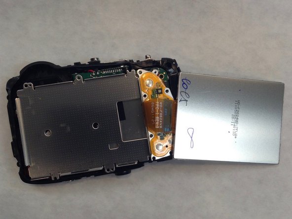

  8. Fujifilm XP20 LCD Screen Replacement: crwdns2935265:08crwdnd2935265:01crwdnd2935265:02crwdne2935265:0 Fujifilm XP20 LCD Screen Replacement: crwdns2935265:08crwdnd2935265:02crwdnd2935265:02crwdne2935265:0
    • Take the spudger again and wedge it in the thinner frame to pry the LCD screen from the frame.
    • Make your way around with the spudger just enough to separate the screen and frame once again.

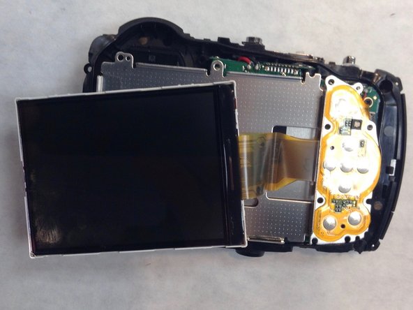

  9. Fujifilm XP20 LCD Screen Replacement: crwdns2935265:09crwdnd2935265:01crwdnd2935265:02crwdne2935265:0 Fujifilm XP20 LCD Screen Replacement: crwdns2935265:09crwdnd2935265:02crwdnd2935265:02crwdne2935265:0

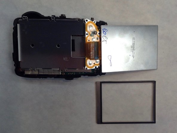

    • Take the spudger and wedge it very carefully between the LCD screen and the very thin and fragile frame.
    • Very carefully make your way around the frame with the spudger, while making sure not to use too much force. Otherwise the screen will be damaged.
  10. Fujifilm XP20 LCD Screen Replacement: crwdns2935265:010crwdnd2935265:01crwdnd2935265:01crwdne2935265:0
    • Detach the LCD screen from the motherboard by detaching the orange ribbon.
