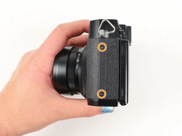

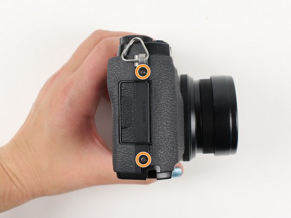

      • Remove all four of the 4.7 mm screws from the sides of the camera.

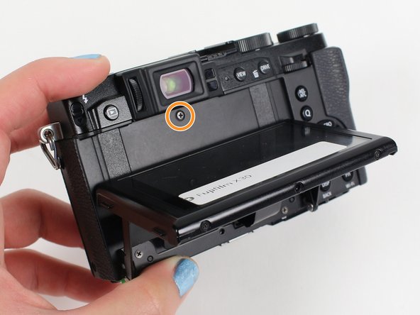

      • Lift up the screen and remove the two 4.5 mm screws located in the bottom corners.
      • Remove the 4.0 mm screw that is located behind the screen and directly under the eye piece.

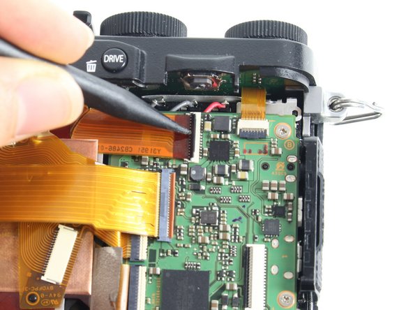

    5. Fujifilm X30 Lens Replacement: crwdns2935265:08crwdnd2935265:01crwdnd2935265:03crwdne2935265:0 Fujifilm X30 Lens Replacement: crwdns2935265:08crwdnd2935265:02crwdnd2935265:03crwdne2935265:0 Fujifilm X30 Lens Replacement: crwdns2935265:08crwdnd2935265:03crwdnd2935265:03crwdne2935265:0
      • For all five indicated orange strips:
      • Use a spudger to lift up the tab holding the orange strip and slide the strip out to disconnect it.
    6. Fujifilm X30 Lens Replacement: crwdns2935265:09crwdnd2935265:01crwdnd2935265:01crwdne2935265:0
      • For the final orange strip located behind the top strip:

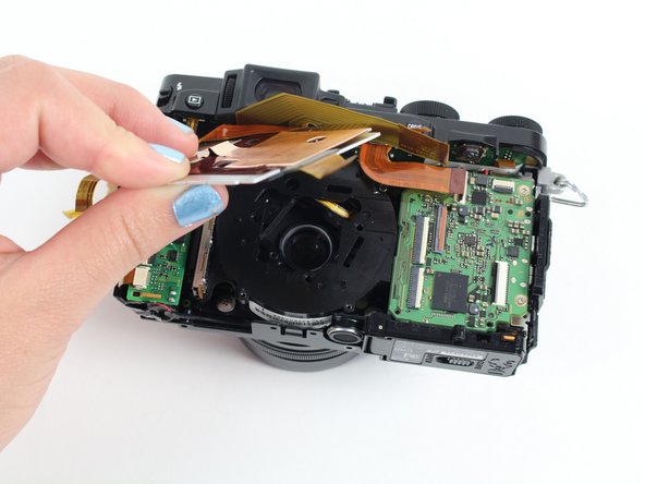

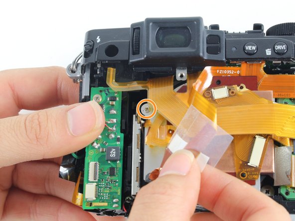

      • Remove all screws listed below using a Phillips #000 Screwdriver:
      • Remove the two 3.4 mm screws at the bottom of the silver plate.
      • Peel back the clear strip to reveal a 2.8 mm screw on the left of the silver plate and remove it.
      • Peel back the copper plate.

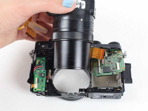

    9. Fujifilm X30 Lens Replacement: crwdns2935265:012crwdnd2935265:01crwdnd2935265:01crwdne2935265:0
      • Remove the four 4.4 mm silver screws at the corners of the lens using a Phillips #000 Screwdriver.
    10. Fujifilm X30 Lens Replacement: crwdns2935265:013crwdnd2935265:01crwdnd2935265:02crwdne2935265:0 Fujifilm X30 Lens Replacement: crwdns2935265:013crwdnd2935265:02crwdnd2935265:02crwdne2935265:0
      • Pull the lens down so it can clear the silver tab.
      • Then push the lens with your index fingers from the front of the camera until it is removed.
