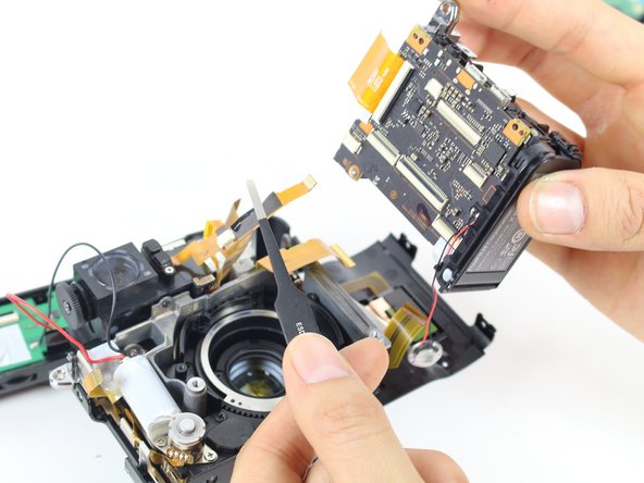

  40. Fujifilm X100T Disassembly: crwdns2935265:040crwdnd2935265:01crwdnd2935265:03crwdne2935265:0 Fujifilm X100T Disassembly: crwdns2935265:040crwdnd2935265:02crwdnd2935265:03crwdne2935265:0 Fujifilm X100T Disassembly: crwdns2935265:040crwdnd2935265:03crwdnd2935265:03crwdne2935265:0
    • Using the precision tweezers, remove the white strip from the corner of the motherboard.
    • Remove the two 4.0 mm screws from the top left and the bottom left.
    • After the screws are removed, carefully detach the motherboard from the battery case by carefully separating the two parts.

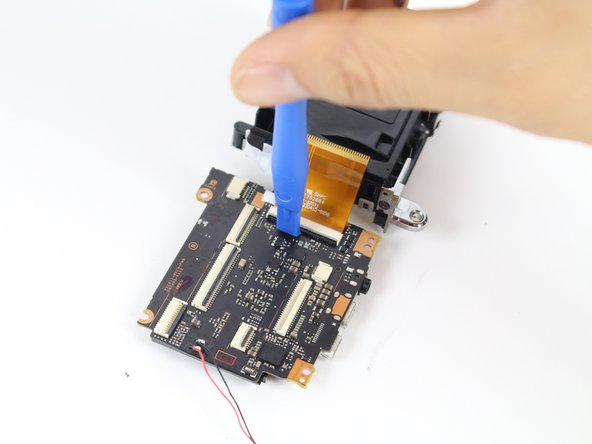

  41. Fujifilm X100T Disassembly: crwdns2935265:041crwdnd2935265:01crwdnd2935265:02crwdne2935265:0 Fujifilm X100T Disassembly: crwdns2935265:041crwdnd2935265:02crwdnd2935265:02crwdne2935265:0
    • Use the plastic opening tool to remove the orange ribbon on the motherboard by wedging the tool under the ribbons black tab, and carefully prying upwards.

    • Desolder the wires connecting the motherboard and battery case.
    • You are now left with a standalone motherboard.
  43. Fujifilm X100T Disassembly, Fujifilm X100T Disassembly: crwdns2935265:043crwdnd2935265:01crwdnd2935265:01crwdne2935265:0
    • You have disassembled the Fujifilm X100T!
