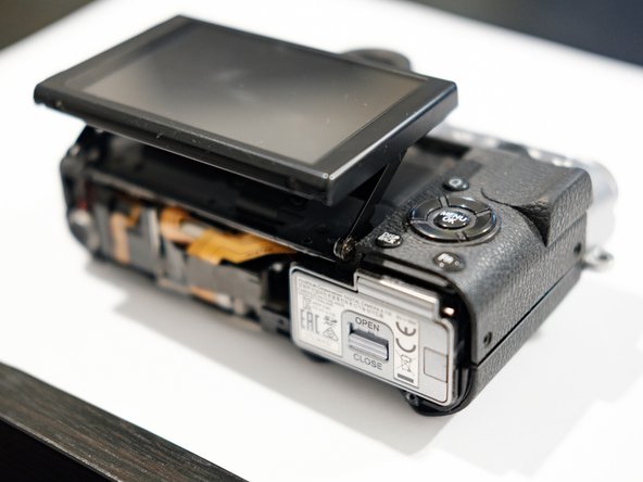

    • Slowly pry and slide the bottom cover down.
  6. Fujifilm X-T10 top assembly removal, Remove the back assembly with LCD: crwdns2935265:06crwdnd2935265:01crwdnd2935265:01crwdne2935265:0
    • Work slowly on this step. There is a chance of ripping a ribbon cable.
    • Start prying and lifting the back LCD assembly
    • To remove the ribbon cable, flip up the WHITE lock on the large ZIF connector with the flat end of a spudger.

Hello community,
my x-t10 is broken: as soon as the camera lens attaches, the screen (also EVF) was blinking, switching on and off, after roughly 20s LCD displays "Lens Error". As described in detail in this post (https://www.fuji-x-forum.com/topic/8121-...), some people were able to disassemble the motherboard and change broken fuses.
Can someone help me to find the correct spare part fuse?
Is there a manual for changing fuses from a motherboard?
Unfortunately I do not have any experience with such projects.
Thanks in advance
Juri
berlinerjuri - crwdns2934203:0crwdne2934203:0
Hi Juri,
Personally I am not a complete beginner, but was not able to identify which is a broken part.
Ended up replacing the motherboard and in the meantime made this manual.
If you feel comfortable in soldering and have patience for microscopic things try to watch some youtube videos about SMD soldering, motherobard repairs, broken fuse and capacitors identification.
You will also likely to need hot air station, as parts are really microscopic, and regular soldering iron will be too large.
Spare fuses can be found for example in DigiKey, or AliExpress.
Best of luck! and please share your experience if you manage to fix it!
I may be able to fix my old board too and make new tutorial as this seems common issue with this camera.
