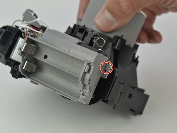

    • Remove the four 4.5 mm #00 Phillips screws on the battery compartment.
  8. Fujifilm Instax Minion Motor Replacement: crwdns2935265:08crwdnd2935265:01crwdnd2935265:01crwdne2935265:0
    • Lift up the battery compartment to free up the motor.
  9. Fujifilm Instax Minion Motor Replacement: crwdns2935265:09crwdnd2935265:01crwdnd2935265:01crwdne2935265:0

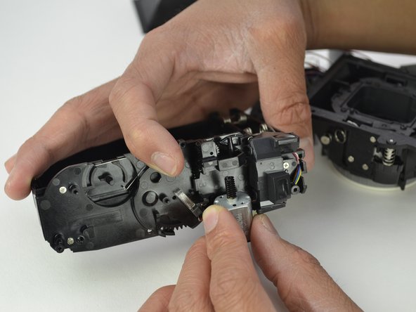

    • Unscrew the two 2.9mm Phillips #00 screws holding the motor to the frame.
  10. Fujifilm Instax Minion Motor Replacement: crwdns2935265:010crwdnd2935265:01crwdnd2935265:02crwdne2935265:0 Fujifilm Instax Minion Motor Replacement: crwdns2935265:010crwdnd2935265:02crwdnd2935265:02crwdne2935265:0
    • Remove the motor from the frame.
  11. Fujifilm Instax Minion Motor Replacement: crwdns2935265:011crwdnd2935265:01crwdnd2935265:02crwdne2935265:0 Fujifilm Instax Minion Motor Replacement: crwdns2935265:011crwdnd2935265:02crwdnd2935265:02crwdne2935265:0
    • Desolder the wires from the leads of the capacitor.
    • Take note of the connections between the wires and leads for reassembly.
