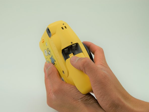

    • Use a spudger to remove the film slot guard on the top of the camera.
    • Remove the one 4.5 mm #00 Phillips screw under the slot guard.

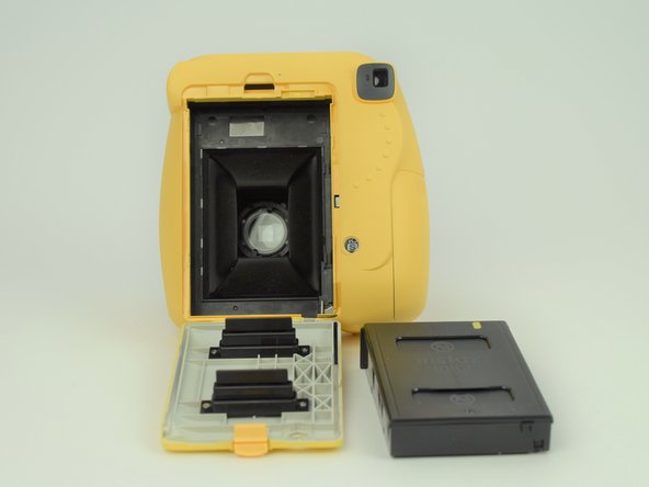

    • Press the release tab on the back of the camera to open the film compartment.
    • Remove the film cartridge within this compartment.

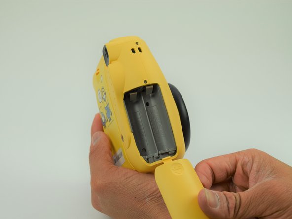

    • Press the battery cover in and down to remove it.
    • Remove any batteries within.

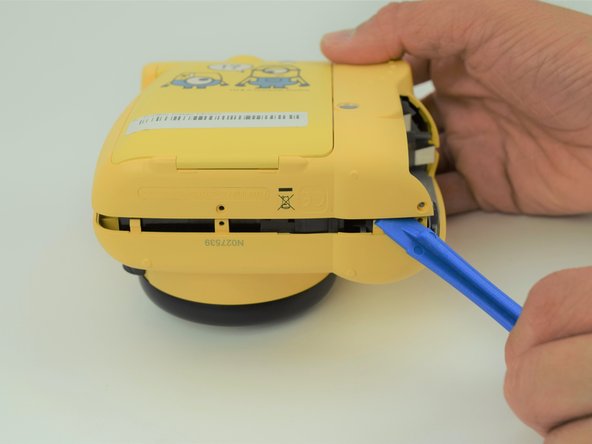

    • Use a plastic opening tool to help pry the front and back shells apart.
    • With the camera facing down, remove only the back shell.

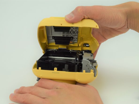

  6. Fujifilm Instax Minion Lens Bellow Replacement: crwdns2935265:06crwdnd2935265:01crwdnd2935265:03crwdne2935265:0 Fujifilm Instax Minion Lens Bellow Replacement: crwdns2935265:06crwdnd2935265:02crwdnd2935265:03crwdne2935265:0 Fujifilm Instax Minion Lens Bellow Replacement: crwdns2935265:06crwdnd2935265:03crwdnd2935265:03crwdne2935265:0
    • Carefully peel the front side of the shell away.
    • As you lift the front shell, be careful to not pull too hard since there is a spring attached to the shell and the camera body.
    • Using a set of tweezers, detach the spring from the body. The spring will retract into the black and gray ring on the front shell.

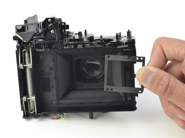

    • Turn the camera onto its back and remove the four 4.5 mm screws attaching the lens bellow to the case using a Phillips #00 screwdriver.
    • The lens must be extended in order to have access to the screws.
    • Remove the rectangular screw casing from the back of the camera.

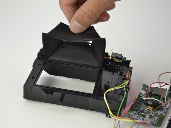

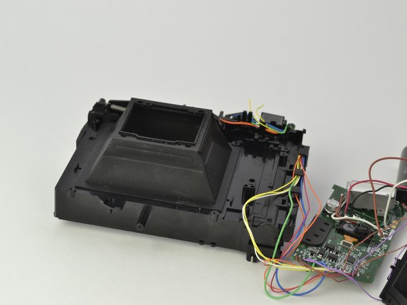

    • Flip the camera over to its front side again and remove the lens casing by lifting it up and off the camera.
    • Finally, remove the lens bellow by lifting it up and off the camera.
