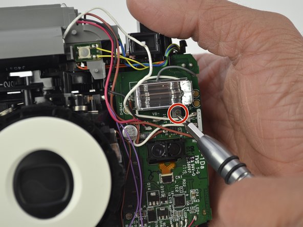

    • Once the shell is off, remove the one 6.5 mm screw that is attached to the flash bulb using a Phillips #00 screwdriver.
  8. Fujifilm Instax Minion Flash Bulb Replacement: crwdns2935265:08crwdnd2935265:01crwdnd2935265:03crwdne2935265:0 Fujifilm Instax Minion Flash Bulb Replacement: crwdns2935265:08crwdnd2935265:02crwdnd2935265:03crwdne2935265:0 Fujifilm Instax Minion Flash Bulb Replacement: crwdns2935265:08crwdnd2935265:03crwdnd2935265:03crwdne2935265:0

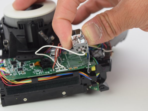

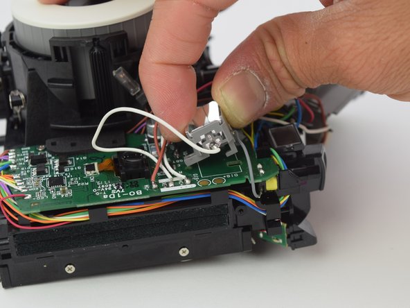

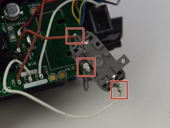

    • Place the bulb over an open surface and use the soldering gun to melt the three connections off the bulb.
    • During reassembly, use the picture to attach the correct wire to the correct connection on the bulb (white-right, gray-top, brown-left).
  10. Fujifilm Instax Minion Flash Bulb Replacement: crwdns2935265:010crwdnd2935265:01crwdnd2935265:01crwdne2935265:0
    • The flash bulb should now be detached completely from the circuit board.
