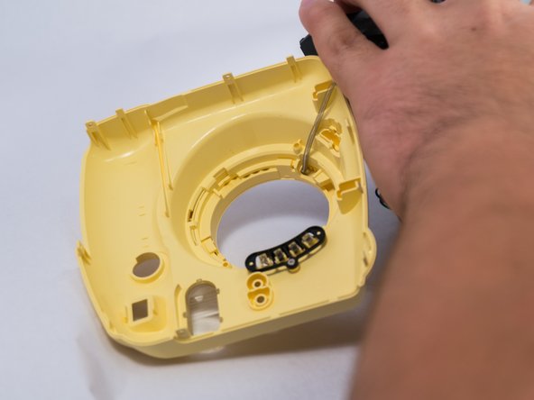

    • Use the plastic opening tools and spudger to safely remove the front shell casing.
  4. Fujifilm Instax Mini Eight Camera Shell Replacement: crwdns2935265:04crwdnd2935265:01crwdnd2935265:02crwdne2935265:0 Fujifilm Instax Mini Eight Camera Shell Replacement: crwdns2935265:04crwdnd2935265:02crwdnd2935265:02crwdne2935265:0
    • Lift the front part of shell up, assuring not to pull too hard due a spring that is connect to the shell and the inside of the camera.
    • Carefully, using a small #00 Philips head screwdriver, remove the spring from the inside component of the camera.
    • At this point you should have the shell removed completely. Congratulations! Repeat the steps backwards to get the shell back on your camera unit.
