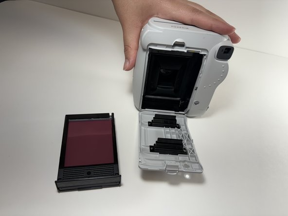

  3. Fujifilm Instax Mini 9 Flash Capacitor Replacement, Remove the Film Cartridge: crwdns2935265:03crwdnd2935265:01crwdnd2935265:02crwdne2935265:0 Fujifilm Instax Mini 9 Flash Capacitor Replacement, Remove the Film Cartridge: crwdns2935265:03crwdnd2935265:02crwdnd2935265:02crwdne2935265:0
    • Turn the camera to its back side and push down on the clip at the top of the film cover and remove film.

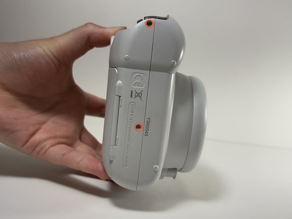

  4. Fujifilm Instax Mini 9 Flash Capacitor Replacement, Remove Shell Screws: crwdns2935265:04crwdnd2935265:01crwdnd2935265:03crwdne2935265:0 Fujifilm Instax Mini 9 Flash Capacitor Replacement, Remove Shell Screws: crwdns2935265:04crwdnd2935265:02crwdnd2935265:03crwdne2935265:0 Fujifilm Instax Mini 9 Flash Capacitor Replacement, Remove Shell Screws: crwdns2935265:04crwdnd2935265:03crwdnd2935265:03crwdne2935265:0
    • Remove the six shell screws highlighted using a Philips #00 screwdriver.

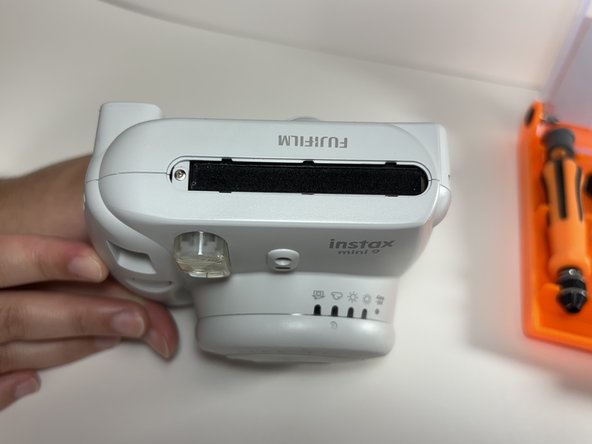

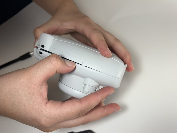

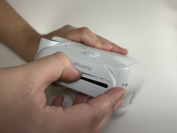

  5. Fujifilm Instax Mini 9 Flash Capacitor Replacement, Remove Printer Shroud: crwdns2935265:05crwdnd2935265:01crwdnd2935265:03crwdne2935265:0 Fujifilm Instax Mini 9 Flash Capacitor Replacement, Remove Printer Shroud: crwdns2935265:05crwdnd2935265:02crwdnd2935265:03crwdne2935265:0 Fujifilm Instax Mini 9 Flash Capacitor Replacement, Remove Printer Shroud: crwdns2935265:05crwdnd2935265:03crwdnd2935265:03crwdne2935265:0
    • Remove the shroud for the film printer. Carefully pry around the edge of the shroud until the part comes loose.

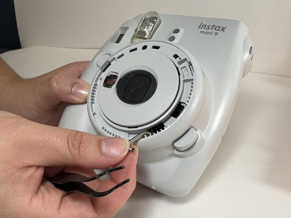

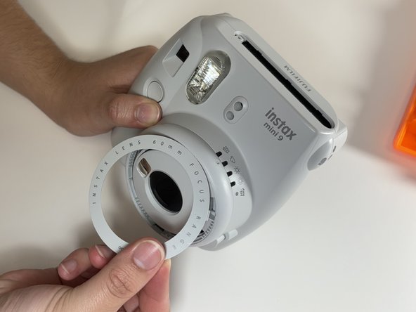

  6. Fujifilm Instax Mini 9 Flash Capacitor Replacement, Pry Off the Lens Shroud: crwdns2935265:06crwdnd2935265:01crwdnd2935265:02crwdne2935265:0 Fujifilm Instax Mini 9 Flash Capacitor Replacement, Pry Off the Lens Shroud: crwdns2935265:06crwdnd2935265:02crwdnd2935265:02crwdne2935265:0
    • Carefully pry around the lens shroud in a circular motion in order to remove it.

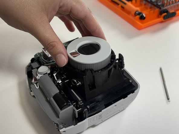

  7. Fujifilm Instax Mini 9 Flash Capacitor Replacement, Unhook Lens Spring: crwdns2935265:07crwdnd2935265:01crwdnd2935265:02crwdne2935265:0 Fujifilm Instax Mini 9 Flash Capacitor Replacement, Unhook Lens Spring: crwdns2935265:07crwdnd2935265:02crwdnd2935265:02crwdne2935265:0
    • Unhook the spring attached to the lens.

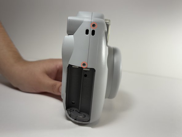

  10. Fujifilm Instax Mini 9 Flash Capacitor Replacement, Remove Battery Slot: crwdns2935265:010crwdnd2935265:01crwdnd2935265:02crwdne2935265:0 Fujifilm Instax Mini 9 Flash Capacitor Replacement, Remove Battery Slot: crwdns2935265:010crwdnd2935265:02crwdnd2935265:02crwdne2935265:0
    • Remove the battery slot by unscrewing the two highlighted screws. Once loose, remove the piece to reveal the capacitor.
    • Note: These two screws are smaller than the case screws removed earlier.

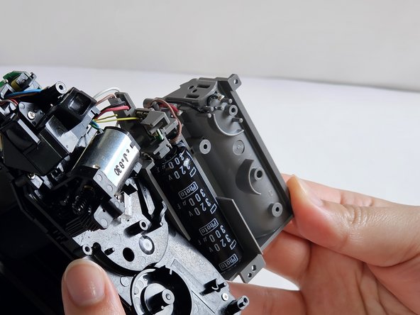

  11. Fujifilm Instax Mini 9 Flash Capacitor Replacement, Remove Capacitor: crwdns2935265:011crwdnd2935265:01crwdnd2935265:01crwdne2935265:0
    • Heat the soldering iron up to 600°F and firmly hold it onto the soldered contacts.
    • Replace the flash capacitor by de-soldering the highlighted contacts.
    • Use a soldering wick or a vacuum pump to absorb the melted solder and remove capacitor once the wires are separated from the contacts.
    • Note: The capacitor is rated for 320V and has a capacitance of 300µF
  12. Fujifilm Instax Mini 9 Flash Capacitor Replacement, Resolder the Wires: crwdns2935265:012crwdnd2935265:01crwdnd2935265:01crwdne2935265:0
    • Solder the two white wires back into place.
