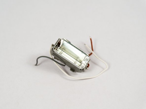

    5. Fujifilm Instax Mini 8 Flash Unit Replacement: crwdns2935265:05crwdnd2935265:01crwdnd2935265:01crwdne2935265:0
      • You should now be able to see the flash unit. Take care to not touch the large black capacitor on the top. It will still have a charge and will hurt.
    6. Fujifilm Instax Mini 8 Flash Unit Replacement: crwdns2935265:06crwdnd2935265:01crwdnd2935265:02crwdne2935265:0 Fujifilm Instax Mini 8 Flash Unit Replacement: crwdns2935265:06crwdnd2935265:02crwdnd2935265:02crwdne2935265:0
      • Unscrew the two screws attaching the flash to the main circuit board. The flash unit will detach away from the motherboard, now leaving just the connecting wires to remove next.
    7. Fujifilm Instax Mini 8 Flash Unit Replacement: crwdns2935265:07crwdnd2935265:01crwdnd2935265:03crwdne2935265:0 Fujifilm Instax Mini 8 Flash Unit Replacement: crwdns2935265:07crwdnd2935265:02crwdnd2935265:03crwdne2935265:0 Fujifilm Instax Mini 8 Flash Unit Replacement: crwdns2935265:07crwdnd2935265:03crwdnd2935265:03crwdne2935265:0
      • With a solder kit, heat the connecting solder points to open the connection, thus removing the connecting wires. There are many ways to do this, depending on the available tools on hand.
