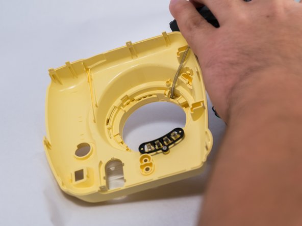

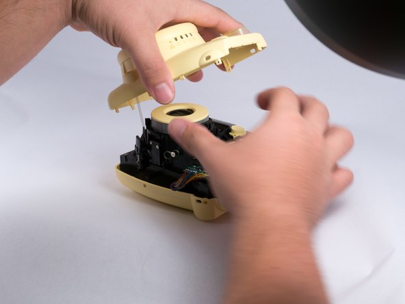

    • Once all screws are removed, gently pry open the front casing with your hands or plastic opening tools carefully. Do note that there will be a spring that attaches the front casing and the main circuit board, so refrain from allowing excess tension on the spring.

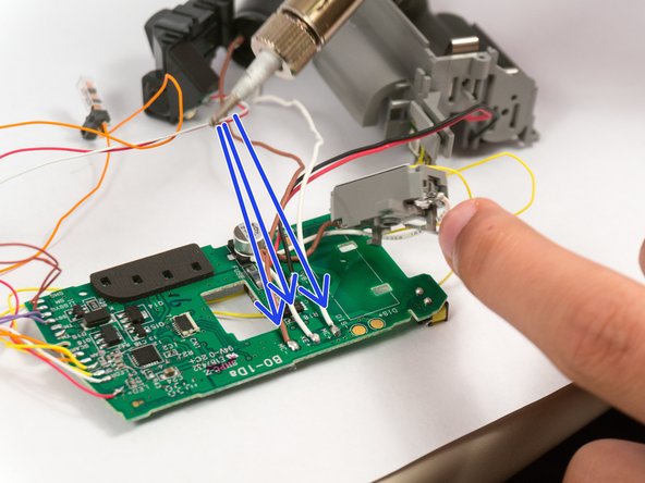

    • Locate the photo-flash capacitor, then find all the connecting wires to the motherboard and battery compartment. Take notes to which exact wires they are to limit mistakes.

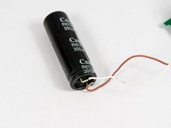

    • Carefully pry out the capacitor with a spudger or plastic opening tools.

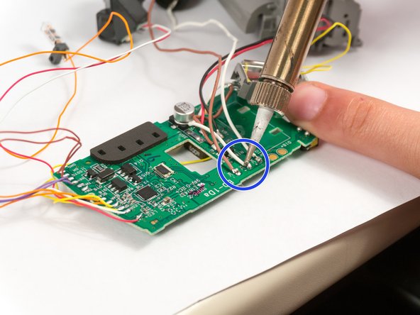

    • With a solder kit, heat the connecting solder points to open the connection, thus removing the connecting wires. There are many ways to do this, depending on the available tools on hand.
