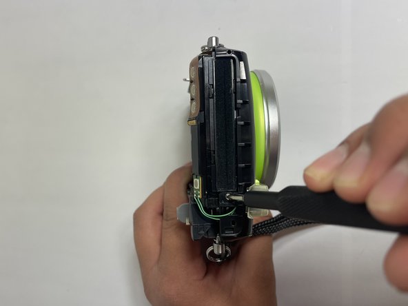

  3. Fujifilm Instax Mini 70 Shell Replacement: crwdns2935265:03crwdnd2935265:01crwdnd2935265:02crwdne2935265:0 Fujifilm Instax Mini 70 Shell Replacement: crwdns2935265:03crwdnd2935265:02crwdnd2935265:02crwdne2935265:0
    • At the top of the camera, locate the 8 mm Phillips #0 screw and remove it.

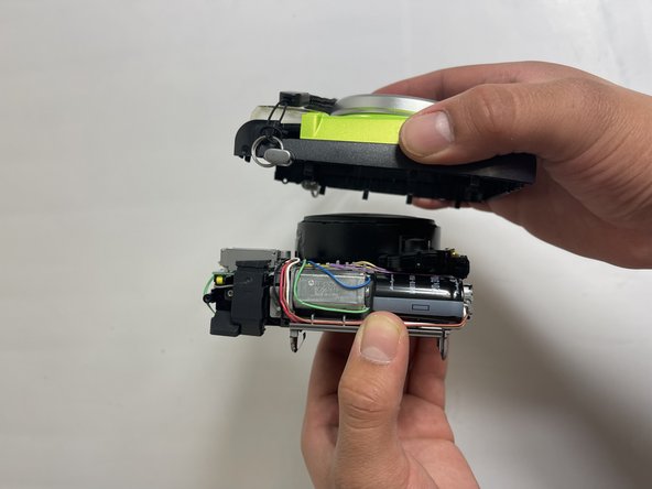

  4. Fujifilm Instax Mini 70 Shell Replacement: crwdns2935265:04crwdnd2935265:01crwdnd2935265:03crwdne2935265:0 Fujifilm Instax Mini 70 Shell Replacement: crwdns2935265:04crwdnd2935265:02crwdnd2935265:03crwdne2935265:0 Fujifilm Instax Mini 70 Shell Replacement: crwdns2935265:04crwdnd2935265:03crwdnd2935265:03crwdne2935265:0
    • Use your hands to gently pull the front shell off of the camera.
