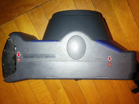

    • Undo the 2 long Phillips screws located on the handles that hold the strap.
    • Next, undo the 2 short Phillips screws on the bottom of the camera. These are all the screws you will have to remove in order to pull the case apart.

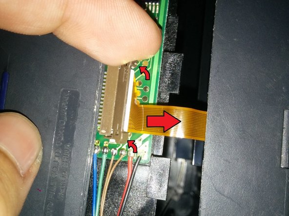

    • Start pulling the 2 halves of the case apart very slowly, while facing the bottom of the camera.
    • Watch out for the fragile ribbon cable! Do not try to pull the 2 halves completely apart until you disconnect it.
    • Using both hands, pull the connector tab up gently while pulling the ribbon away slowly, so that you don't damage it, as shown in the second photo.
