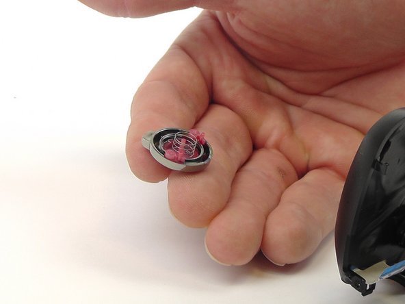

  12. Fujifilm Finepix S1800 Shutter Button Replacement, Shutter Button: crwdns2935265:012crwdnd2935265:01crwdnd2935265:01crwdne2935265:0
    • Remove the two 2 mm screws underneath the plate with the Phillips #000 screwdriver.
  13. Fujifilm Finepix S1800 Shutter Button Replacement: crwdns2935265:013crwdnd2935265:01crwdnd2935265:02crwdne2935265:0 Fujifilm Finepix S1800 Shutter Button Replacement: crwdns2935265:013crwdnd2935265:02crwdnd2935265:02crwdne2935265:0
    • The button should fall right out.
