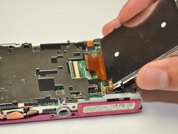

  4. Fujifilm FinePix Z5 Motherboard Replacement: crwdns2935265:04crwdnd2935265:01crwdnd2935265:02crwdne2935265:0 Fujifilm FinePix Z5 Motherboard Replacement: crwdns2935265:04crwdnd2935265:02crwdnd2935265:02crwdne2935265:0
    • Pull the LCD screen to the left slightly, then lift and flip it open to the right.
    • There is also a ribbon cable attaching the LCD screen to the motherboard, be careful not to tear it.

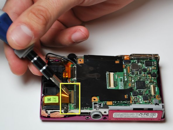

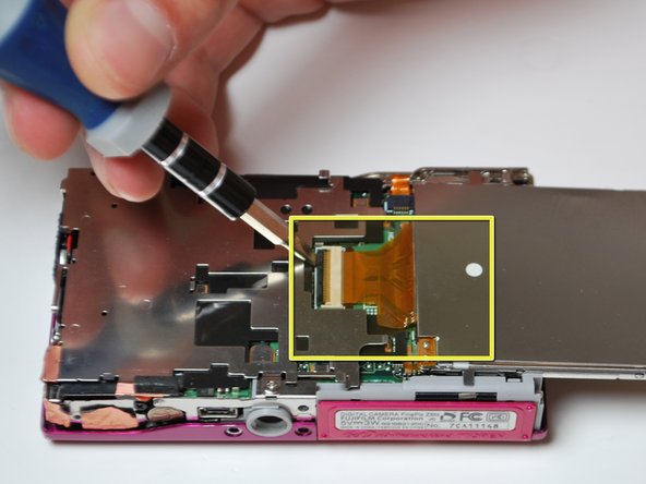

  5. Fujifilm FinePix Z5 Motherboard Replacement: crwdns2935265:05crwdnd2935265:01crwdnd2935265:02crwdne2935265:0 Fujifilm FinePix Z5 Motherboard Replacement: crwdns2935265:05crwdnd2935265:02crwdnd2935265:02crwdne2935265:0
    • Using a plastic opening tool, flip open the black lever to release the ribbon cable.
    • Gently slide the cable out of the lock; the LCD screen is now free to be removed.

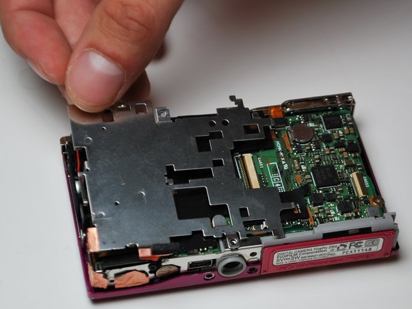

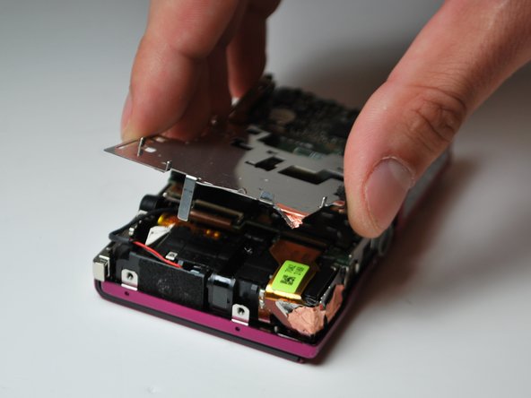

  6. Fujifilm FinePix Z5 Motherboard Replacement: crwdns2935265:06crwdnd2935265:01crwdnd2935265:03crwdne2935265:0 Fujifilm FinePix Z5 Motherboard Replacement: crwdns2935265:06crwdnd2935265:02crwdnd2935265:03crwdne2935265:0 Fujifilm FinePix Z5 Motherboard Replacement: crwdns2935265:06crwdnd2935265:03crwdnd2935265:03crwdne2935265:0
    • Remove the two screws that are holding the silver paneling on.
    • There is a gold ribbon cable which will tear upon removal of the silver paneling, this is normal.
    • Remove the screw on the right side which is anchoring the motherboard.

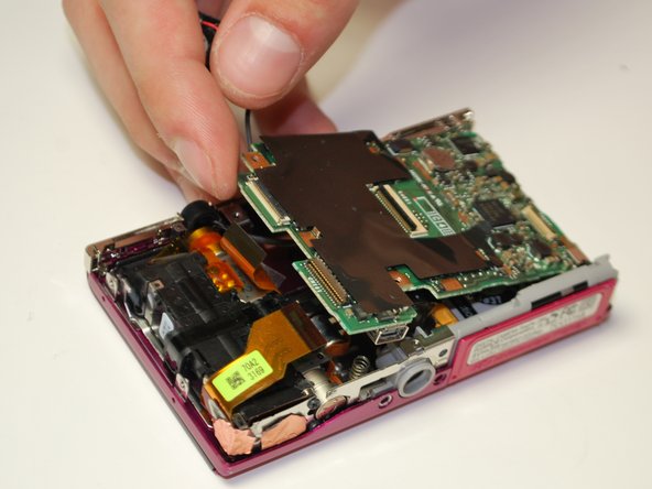

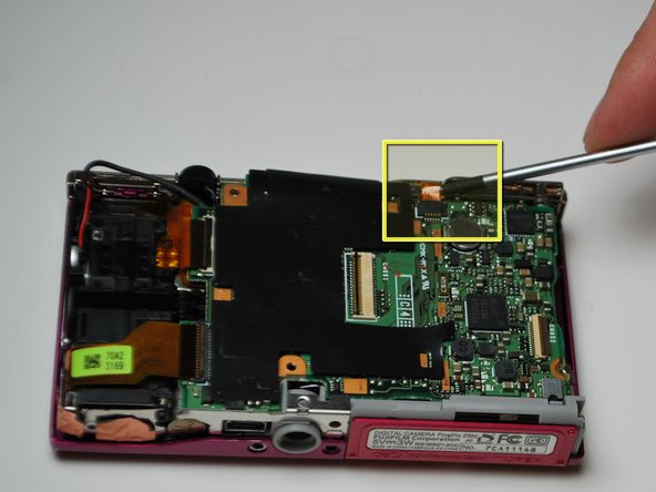

  7. Fujifilm FinePix Z5 Motherboard Replacement: crwdns2935265:07crwdnd2935265:01crwdnd2935265:03crwdne2935265:0 Fujifilm FinePix Z5 Motherboard Replacement: crwdns2935265:07crwdnd2935265:02crwdnd2935265:03crwdne2935265:0 Fujifilm FinePix Z5 Motherboard Replacement: crwdns2935265:07crwdnd2935265:03crwdnd2935265:03crwdne2935265:0
    • Detach the two ribbon cables on the left side of the camera the same way the LCD cable was detached.
    • Detach the gold ribbon cable on the top middle of the camera as well.

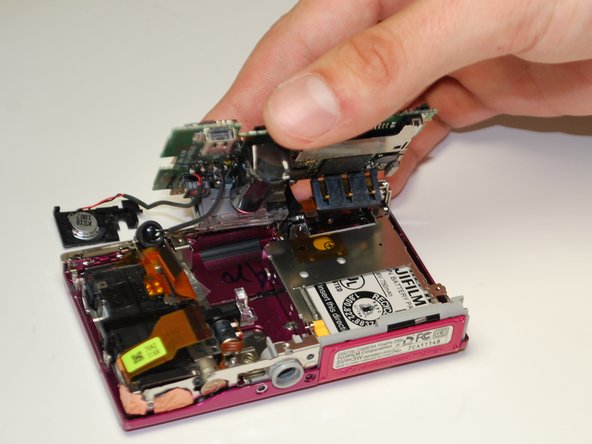

  8. Fujifilm FinePix Z5 Motherboard Replacement: crwdns2935265:08crwdnd2935265:01crwdnd2935265:03crwdne2935265:0 Fujifilm FinePix Z5 Motherboard Replacement: crwdns2935265:08crwdnd2935265:02crwdnd2935265:03crwdne2935265:0 Fujifilm FinePix Z5 Motherboard Replacement: crwdns2935265:08crwdnd2935265:03crwdnd2935265:03crwdne2935265:0
    • Hold wires on the left with an index finger.
    • Carefully wiggle out the motherboard. The flash and the speaker will come with it.
    • Make sure you have a motherboard that includes the flash and the speaker; these items are both soldered onto the motherboard.
