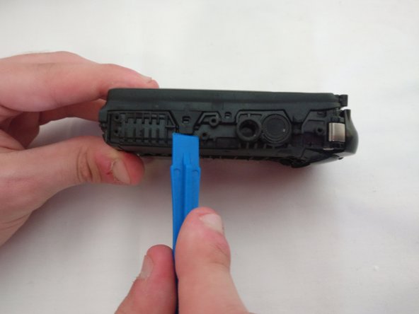

    • Pry the black bottom plate off using a plastic opening tool.
    • It is easier to start on the side of the open battery compartment.

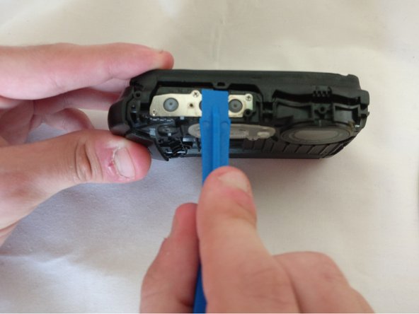

  10. Fujifilm FinePix XP70 Back Button Replacement: crwdns2935265:010crwdnd2935265:01crwdnd2935265:02crwdne2935265:0 Fujifilm FinePix XP70 Back Button Replacement: crwdns2935265:010crwdnd2935265:02crwdnd2935265:02crwdne2935265:0
    • Pry the front plate off using a plastic opening tool.
    • It's recommended to start at the ridge on the top or bottom side.

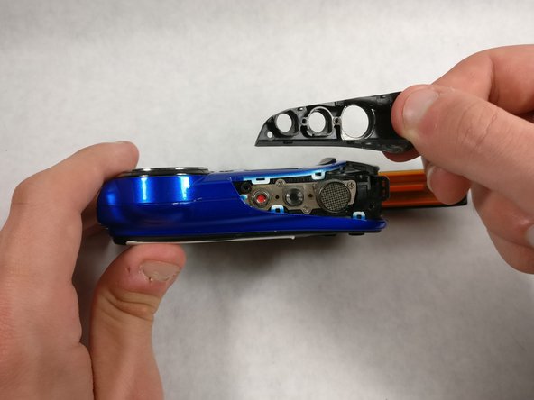

  11. Fujifilm FinePix XP70 Back Button Replacement: crwdns2935265:011crwdnd2935265:01crwdnd2935265:01crwdne2935265:0
    • Lift off the front plate.

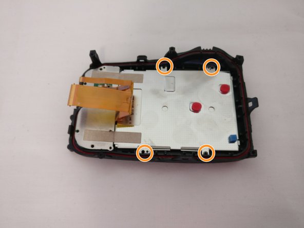

  16. Fujifilm FinePix XP70 Back Button Replacement: crwdns2935265:016crwdnd2935265:01crwdnd2935265:02crwdne2935265:0 Fujifilm FinePix XP70 Back Button Replacement: crwdns2935265:016crwdnd2935265:02crwdnd2935265:02crwdne2935265:0
    • Unscrew seven 4.0 mm screws with a Phillips 00 screwdriver.
    • Unscrew four 3.0 mm screws with a Phillips 00 screwdriver..
