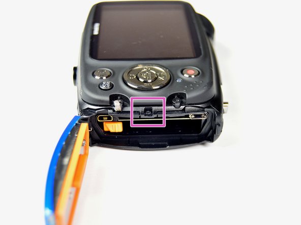

    • Using 1.5mm Hex Screwdriver, remove two 3.0 mm hex screws on the front of the camera.
    • Using Phillips #00 screwdriver, remove two 3.0 mm screws on the bottom of the front face.
  2. Fujifilm FinePix XP50 Rear Case Replacement: crwdns2935265:02crwdnd2935265:01crwdnd2935265:03crwdne2935265:0 Fujifilm FinePix XP50 Rear Case Replacement: crwdns2935265:02crwdnd2935265:02crwdnd2935265:03crwdne2935265:0 Fujifilm FinePix XP50 Rear Case Replacement: crwdns2935265:02crwdnd2935265:03crwdnd2935265:03crwdne2935265:0
    • Using Phillips #00 screwdriver, remove 3.0 mm screws on the bottom of the camera closer to the back.
    • Using Phillips #00 screwdriver remove two 3.0 mm screws on the back of the camera. This will remove the eyelet for the camera strap and the rear cover.
  3. Fujifilm FinePix XP50 Rear Case Replacement: crwdns2935265:03crwdnd2935265:01crwdnd2935265:01crwdne2935265:0
    • Using Phillips #00 screwdriver, remove the two 3.0 mm screws.
  4. Fujifilm FinePix XP50 Rear Case Replacement: crwdns2935265:04crwdnd2935265:01crwdnd2935265:03crwdne2935265:0 Fujifilm FinePix XP50 Rear Case Replacement: crwdns2935265:04crwdnd2935265:02crwdnd2935265:03crwdne2935265:0 Fujifilm FinePix XP50 Rear Case Replacement: crwdns2935265:04crwdnd2935265:03crwdnd2935265:03crwdne2935265:0
    • Using 1.5mm Hex screwdriver, remove 3.0 mm hex screw on top edge of silver panel.
    • Using Phillips #00 screwdriver, remove 3.0 mm screw on bottom edge.
    • Once both screws are removed the silver side casing will slide off.

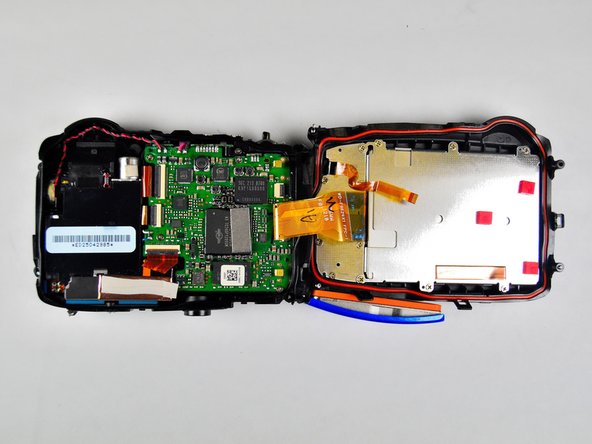

  5. Fujifilm FinePix XP50 Rear Case Replacement: crwdns2935265:05crwdnd2935265:01crwdnd2935265:03crwdne2935265:0 Fujifilm FinePix XP50 Rear Case Replacement: crwdns2935265:05crwdnd2935265:02crwdnd2935265:03crwdne2935265:0 Fujifilm FinePix XP50 Rear Case Replacement: crwdns2935265:05crwdnd2935265:03crwdnd2935265:03crwdne2935265:0
  6. Fujifilm FinePix XP50 Rear Case Replacement: crwdns2935265:06crwdnd2935265:01crwdnd2935265:03crwdne2935265:0 Fujifilm FinePix XP50 Rear Case Replacement: crwdns2935265:06crwdnd2935265:02crwdnd2935265:03crwdne2935265:0 Fujifilm FinePix XP50 Rear Case Replacement: crwdns2935265:06crwdnd2935265:03crwdnd2935265:03crwdne2935265:0
    • Using Phillips #00 screwdriver, remove seven 3.0 mm screws.
    • Remove the remaining five 3.0 mm screws which hold the rear case and the control panel together.
    • The rear panel is now free from the camera.
