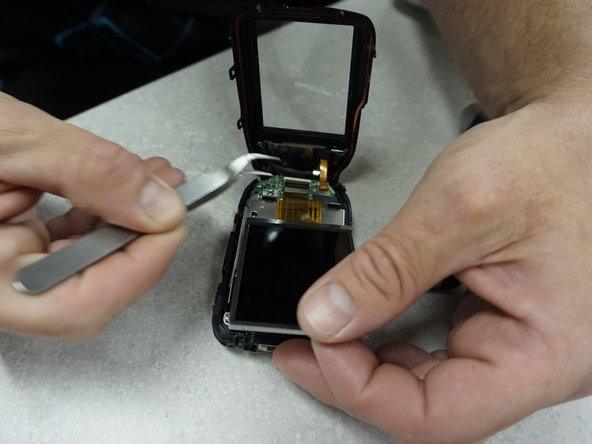

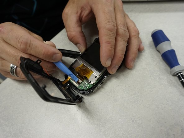

  8. Fujifilm FinePix XP10SE Rear Control Panel Replacement, LCD: crwdns2935265:08crwdnd2935265:01crwdnd2935265:01crwdne2935265:0
    • Locate the securing tabs of the housing unit.
    • Using the spongerslowly work your way around the outside of the case using the sponging tool to pry open the case.
    • *** Take extreme caution when doing this being careful not to break the securing tabs of the housing.
  9. Fujifilm FinePix XP10SE Rear Control Panel Replacement: crwdns2935265:09crwdnd2935265:01crwdnd2935265:01crwdne2935265:0
    • Once the case is open locate the Ribbon cable attachment for the LCD screen.
    • Carefully ensure that the LCD screen is free from all attachments and any tape securing the ribbon cable is released.
  10. Fujifilm FinePix XP10SE Rear Control Panel Replacement: crwdns2935265:010crwdnd2935265:01crwdnd2935265:02crwdne2935265:0 Fujifilm FinePix XP10SE Rear Control Panel Replacement: crwdns2935265:010crwdnd2935265:02crwdnd2935265:02crwdne2935265:0
    • Gently lift up on the black securing bar of the ribbon cable in order to free it from the units motherboard, thus releasing the LCD from the computer.

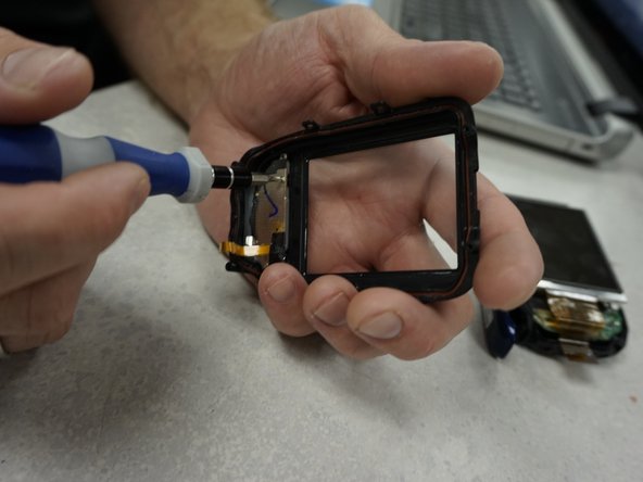

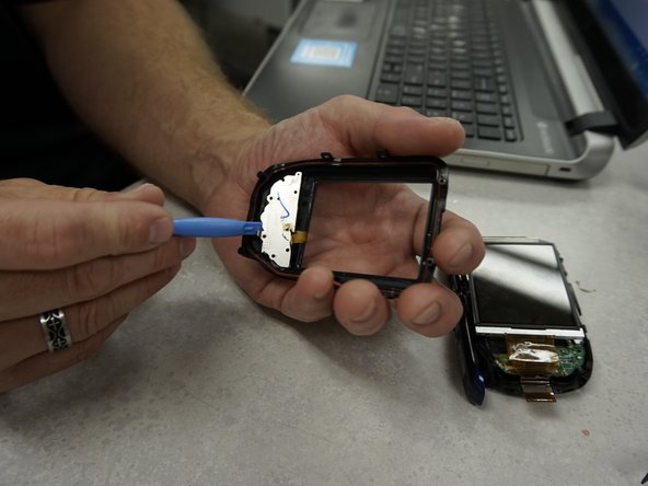

  11. Fujifilm FinePix XP10SE Rear Control Panel Replacement, Rear Control Panel: crwdns2935265:011crwdnd2935265:01crwdnd2935265:03crwdne2935265:0 Fujifilm FinePix XP10SE Rear Control Panel Replacement, Rear Control Panel: crwdns2935265:011crwdnd2935265:02crwdnd2935265:03crwdne2935265:0 Fujifilm FinePix XP10SE Rear Control Panel Replacement, Rear Control Panel: crwdns2935265:011crwdnd2935265:03crwdnd2935265:03crwdne2935265:0
    • Locate the ribbon cable attachment for the rear panel controls.
    • Gently lift the ribbon cable securing bar and slide the ribbon cable from the socket in order to remove the rear control panel.
  12. Fujifilm FinePix XP10SE Rear Control Panel Replacement: crwdns2935265:012crwdnd2935265:01crwdnd2935265:03crwdne2935265:0 Fujifilm FinePix XP10SE Rear Control Panel Replacement: crwdns2935265:012crwdnd2935265:02crwdnd2935265:03crwdne2935265:0 Fujifilm FinePix XP10SE Rear Control Panel Replacement: crwdns2935265:012crwdnd2935265:03crwdnd2935265:03crwdne2935265:0
    • Locate the six screws on the control panel.
    • **two of the screws may be covered by tape. Remove the tape to access them.
    • Use the PH000 Phillip’s screwdriver bit from the Ifixit driver kit to remove the screws and free the control panel from the unit.
