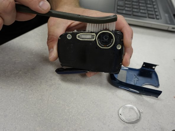

    • Remove the screws from the lens cover
  2. Fujifilm FinePix XP10SE LCD Replacement: crwdns2935265:02crwdnd2935265:01crwdnd2935265:01crwdne2935265:0
    • Remove the screws from the side metal cover of outer case.
  3. Fujifilm FinePix XP10SE LCD Replacement: crwdns2935265:03crwdnd2935265:01crwdnd2935265:02crwdne2935265:0 Fujifilm FinePix XP10SE LCD Replacement: crwdns2935265:03crwdnd2935265:02crwdnd2935265:02crwdne2935265:0
    • Gently remove the Lens from the housing.
  4. Fujifilm FinePix XP10SE LCD Replacement, Front Cover: crwdns2935265:04crwdnd2935265:01crwdnd2935265:03crwdne2935265:0 Fujifilm FinePix XP10SE LCD Replacement, Front Cover: crwdns2935265:04crwdnd2935265:02crwdnd2935265:03crwdne2935265:0 Fujifilm FinePix XP10SE LCD Replacement, Front Cover: crwdns2935265:04crwdnd2935265:03crwdnd2935265:03crwdne2935265:0

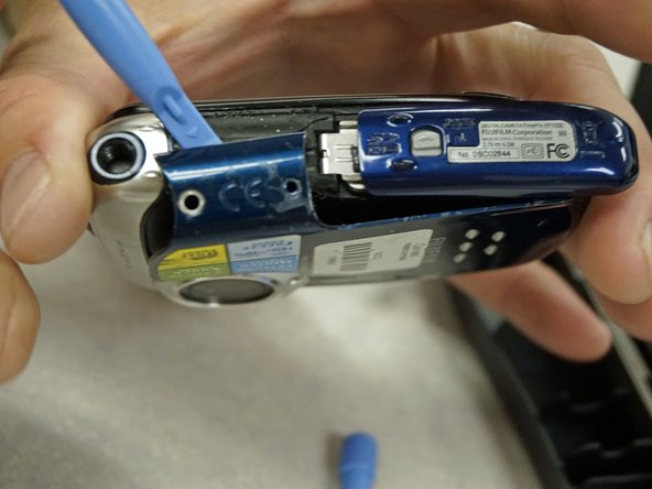

  5. Fujifilm FinePix XP10SE LCD Replacement: crwdns2935265:05crwdnd2935265:01crwdnd2935265:02crwdne2935265:0 Fujifilm FinePix XP10SE LCD Replacement: crwdns2935265:05crwdnd2935265:02crwdnd2935265:02crwdne2935265:0
    • Use a plastic opening tool to detach the case.
  6. Fujifilm FinePix XP10SE LCD Replacement: crwdns2935265:06crwdnd2935265:01crwdnd2935265:02crwdne2935265:0 Fujifilm FinePix XP10SE LCD Replacement: crwdns2935265:06crwdnd2935265:02crwdnd2935265:02crwdne2935265:0
    • Use the plastic opening tool to cautiously pry the casing off of the camera.

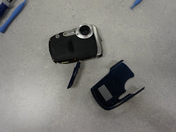

  7. Fujifilm FinePix XP10SE LCD Replacement: crwdns2935265:07crwdnd2935265:01crwdnd2935265:03crwdne2935265:0 Fujifilm FinePix XP10SE LCD Replacement: crwdns2935265:07crwdnd2935265:02crwdnd2935265:03crwdne2935265:0 Fujifilm FinePix XP10SE LCD Replacement: crwdns2935265:07crwdnd2935265:03crwdnd2935265:03crwdne2935265:0
    • Carefully slide the case to the left. Avoid cracking the case on the lens.

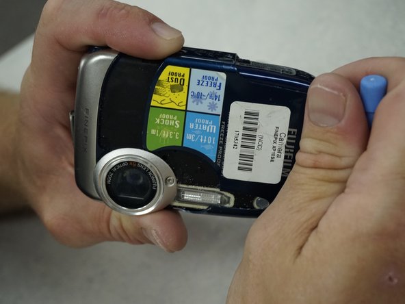

  8. Fujifilm FinePix XP10SE LCD Replacement, LCD: crwdns2935265:08crwdnd2935265:01crwdnd2935265:01crwdne2935265:0
    • Locate the securing tabs of the housing unit.
    • Using the spongerslowly work your way around the outside of the case using the sponging tool to pry open the case.
    • *** Take extreme caution when doing this being careful not to break the securing tabs of the housing.
