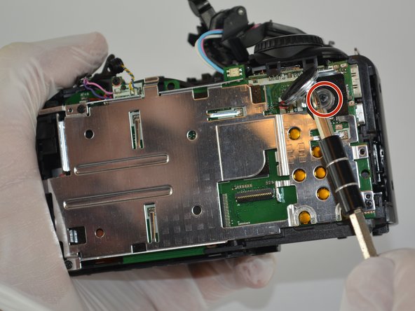

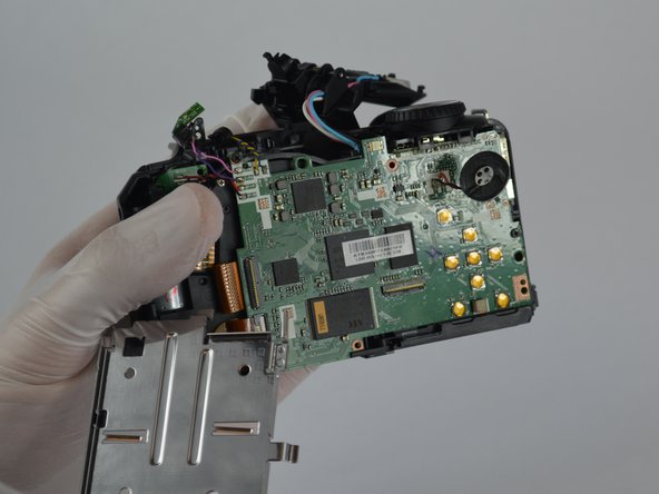

  9. Fujifilm FinePix S8630 Speaker Replacement, Speaker: crwdns2935265:09crwdnd2935265:01crwdnd2935265:03crwdne2935265:0 Fujifilm FinePix S8630 Speaker Replacement, Speaker: crwdns2935265:09crwdnd2935265:02crwdnd2935265:03crwdne2935265:0 Fujifilm FinePix S8630 Speaker Replacement, Speaker: crwdns2935265:09crwdnd2935265:03crwdnd2935265:03crwdne2935265:0
    • Using your Philips head screwdriver remove the screws from the metal shield.
    • Remove the metal shield.

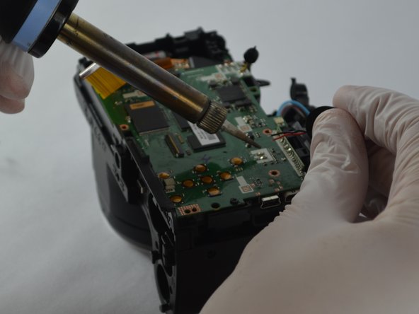

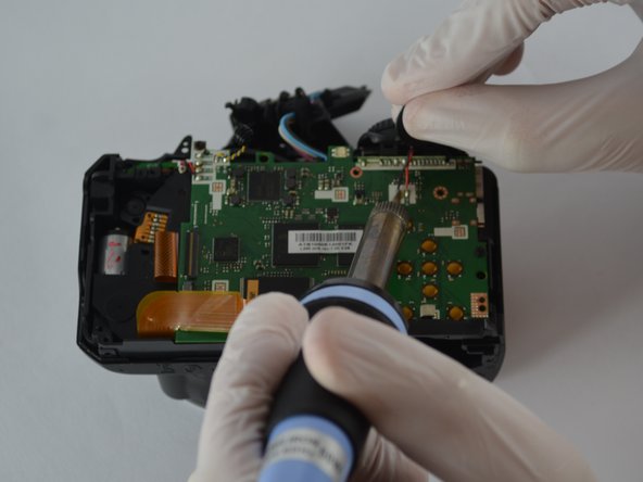

  10. Fujifilm FinePix S8630 Speaker Replacement: crwdns2935265:010crwdnd2935265:01crwdnd2935265:03crwdne2935265:0 Fujifilm FinePix S8630 Speaker Replacement: crwdns2935265:010crwdnd2935265:02crwdnd2935265:03crwdne2935265:0 Fujifilm FinePix S8630 Speaker Replacement: crwdns2935265:010crwdnd2935265:03crwdnd2935265:03crwdne2935265:0
    • Find the speaker and gently pull away from the motherboard. It is just on by an adhesive.
    • Identify where the speaker is connected to the motherboard and unsolder both of the connections,
    • Guide for Soldering: How To Solder and Desolder Connections
