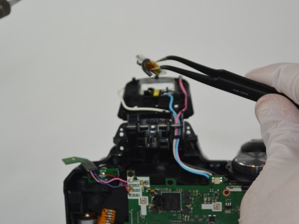

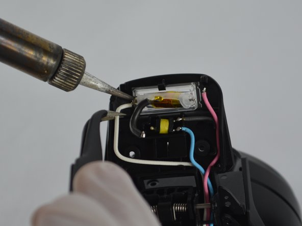

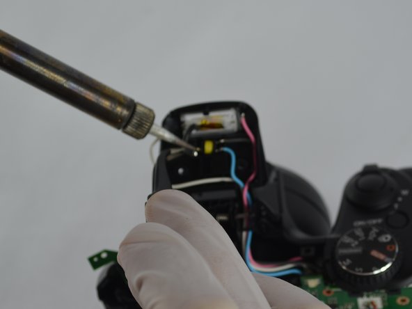

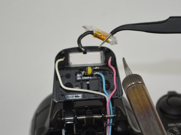

  9. Fujifilm FinePix S8630 Flashbulb Replacement, Flashbulb: crwdns2935265:09crwdnd2935265:01crwdnd2935265:03crwdne2935265:0 Fujifilm FinePix S8630 Flashbulb Replacement, Flashbulb: crwdns2935265:09crwdnd2935265:02crwdnd2935265:03crwdne2935265:0 Fujifilm FinePix S8630 Flashbulb Replacement, Flashbulb: crwdns2935265:09crwdnd2935265:03crwdnd2935265:03crwdne2935265:0
  10. Fujifilm FinePix S8630 Flashbulb Replacement: crwdns2935265:010crwdnd2935265:01crwdnd2935265:03crwdne2935265:0 Fujifilm FinePix S8630 Flashbulb Replacement: crwdns2935265:010crwdnd2935265:02crwdnd2935265:03crwdne2935265:0 Fujifilm FinePix S8630 Flashbulb Replacement: crwdns2935265:010crwdnd2935265:03crwdnd2935265:03crwdne2935265:0
    • Using the tweezers remove the flashbulb.
