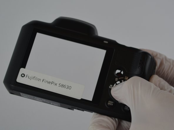

      • Remove the M3 x 4mm screws from the bottom of your device as indicated by the picture. using the Philips Head J0 Screw Driver Bit .
    2. Fujifilm FinePix S8630 Button Panel Replacement: crwdns2935265:02crwdnd2935265:01crwdnd2935265:01crwdne2935265:0
      • Use your Philips Head Screwdriver to remove the M3 x 4mm screws from the left side of the device as indicated by the pictures.
    3. Fujifilm FinePix S8630 Button Panel Replacement: crwdns2935265:03crwdnd2935265:01crwdnd2935265:01crwdne2935265:0
      • Use your Philips Head Screwdriver to remove the M3 x 4mm screws from the right side of the device as indicated by the pictures.
    4. Fujifilm FinePix S8630 Button Panel Replacement: crwdns2935265:04crwdnd2935265:01crwdnd2935265:02crwdne2935265:0 Fujifilm FinePix S8630 Button Panel Replacement: crwdns2935265:04crwdnd2935265:02crwdnd2935265:02crwdne2935265:0
      • Use your Philips Head Screwdriver to remove the M3 x 4mm screws from the camera flash lid as indicated by the picture.
      • Remove the plastic cover from the flash lid by gentle pulling them apart or using the plastic opening tool.
    5. Fujifilm FinePix S8630 Button Panel Replacement: crwdns2935265:05crwdnd2935265:01crwdnd2935265:01crwdne2935265:0
      • Fold the lid down in order to access and remove the final M3 x 4mm screw using your Philips Head Screwdriver.
    6. Fujifilm FinePix S8630 Button Panel Replacement: crwdns2935265:06crwdnd2935265:01crwdnd2935265:03crwdne2935265:0 Fujifilm FinePix S8630 Button Panel Replacement: crwdns2935265:06crwdnd2935265:02crwdnd2935265:03crwdne2935265:0 Fujifilm FinePix S8630 Button Panel Replacement: crwdns2935265:06crwdnd2935265:03crwdnd2935265:03crwdne2935265:0
      • Use the plastic opening tool to pry the back and front casings of the camera apart.
      • Once pried apart use your hands to pull off the back plate of the camera.
      • You will need to apply a little bit of force to remove the back plate.
    7. Fujifilm FinePix S8630 Button Panel Replacement: crwdns2935265:07crwdnd2935265:01crwdnd2935265:03crwdne2935265:0 Fujifilm FinePix S8630 Button Panel Replacement: crwdns2935265:07crwdnd2935265:02crwdnd2935265:03crwdne2935265:0 Fujifilm FinePix S8630 Button Panel Replacement: crwdns2935265:07crwdnd2935265:03crwdnd2935265:03crwdne2935265:0

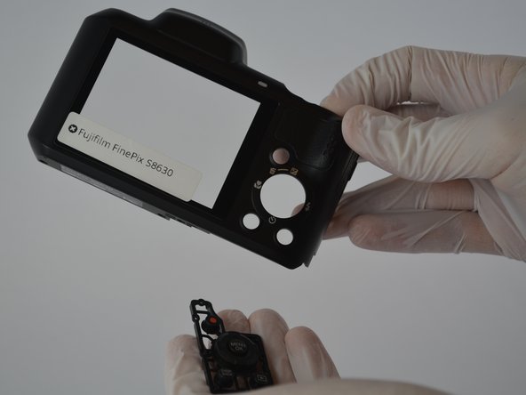

    1. Fujifilm FinePix S8630 Button Panel Replacement, Button Panel: crwdns2935265:08crwdnd2935265:01crwdnd2935265:03crwdne2935265:0 Fujifilm FinePix S8630 Button Panel Replacement, Button Panel: crwdns2935265:08crwdnd2935265:02crwdnd2935265:03crwdne2935265:0 Fujifilm FinePix S8630 Button Panel Replacement, Button Panel: crwdns2935265:08crwdnd2935265:03crwdnd2935265:03crwdne2935265:0
      • Take the back casing and push the button panel out gently. The panel will easily fall out and can easily be replaced.
