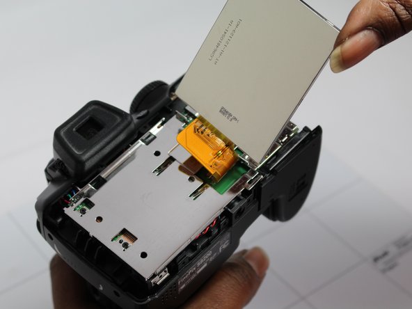

  6. Fujifilm FinePix S8200 LCD Screen  Replacement: crwdns2935265:06crwdnd2935265:01crwdnd2935265:01crwdne2935265:0
    • Remove the rear housing cover by carefully pulling it away from the camera.
  7. Fujifilm FinePix S8200 LCD Screen  Replacement, LCD Screen: crwdns2935265:07crwdnd2935265:01crwdnd2935265:02crwdne2935265:0 Fujifilm FinePix S8200 LCD Screen  Replacement, LCD Screen: crwdns2935265:07crwdnd2935265:02crwdnd2935265:02crwdne2935265:0
    • Fold back the LCD screen with the plastic opening tool.
    • Remove the cable coming from the LCD screen that goes into the motherboard.
