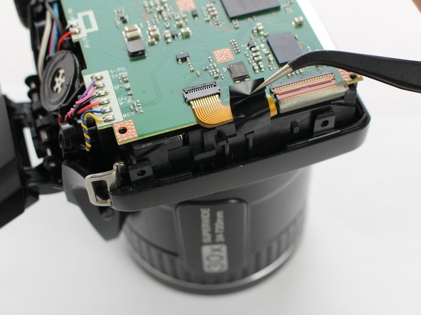

  14. Fujifilm FinePix S4800 Motherboard Replacement: crwdns2935265:014crwdnd2935265:01crwdnd2935265:03crwdne2935265:0 Fujifilm FinePix S4800 Motherboard Replacement: crwdns2935265:014crwdnd2935265:02crwdnd2935265:03crwdne2935265:0 Fujifilm FinePix S4800 Motherboard Replacement: crwdns2935265:014crwdnd2935265:03crwdnd2935265:03crwdne2935265:0
    • Remove the electrical tape off the ZIF cable using tweezers.
    • Gently tilt the the lock for the ZIF cable attached to the motherboard with a plastic removal tool.
    • Pull the ZIF cable from motherboard using tweezers.

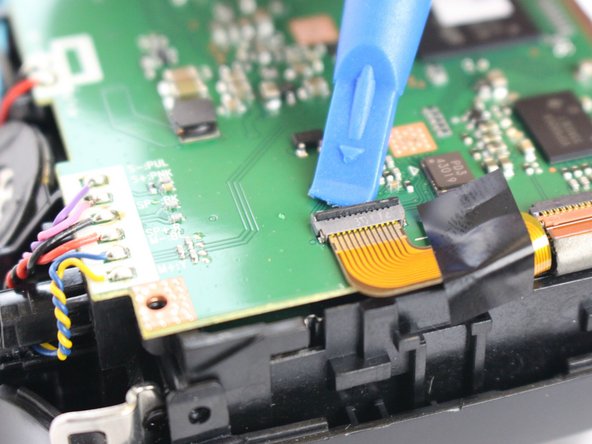

  15. Fujifilm FinePix S4800 Motherboard Replacement: crwdns2935265:015crwdnd2935265:01crwdnd2935265:03crwdne2935265:0 Fujifilm FinePix S4800 Motherboard Replacement: crwdns2935265:015crwdnd2935265:02crwdnd2935265:03crwdne2935265:0 Fujifilm FinePix S4800 Motherboard Replacement: crwdns2935265:015crwdnd2935265:03crwdnd2935265:03crwdne2935265:0
