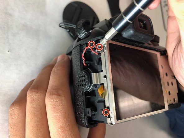

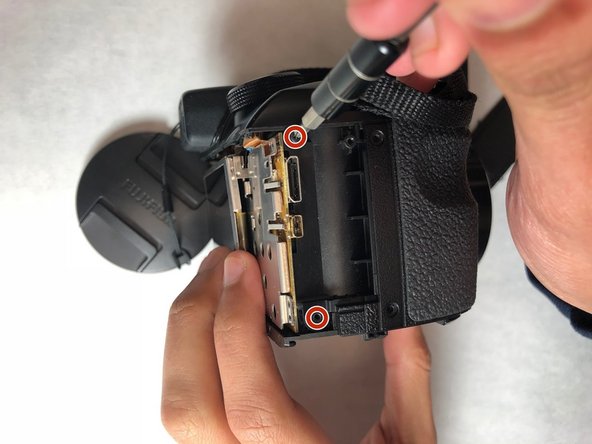

    • Using a Phillips #000 screwdriver, remove all of the 4mm screws from the left, right, and bottom of the camera.

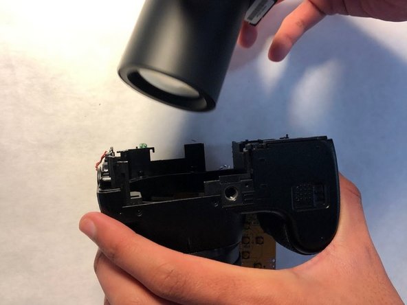

    • Remove casing part pictured by gently pulling up until casing is fully detached.

    • Remove the 4 mm screws on the metal plate. Then remove the 4 mm screws on left side of the camera, and remove the two 4mm screws on right side.
    • Use the Phillips #000 to avoid stripping the screws.

    • Remove orange ribbon cable by gently pulling on the cable until it is detached from the clamping device on the motherboard.
    • Remove the top casing by pulling upwards.

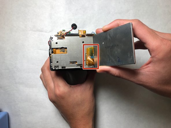

    • Carefully remove the LCD screen.
    • Gently pull on orange tab until it is free. This orange strip is susceptible to tearing.

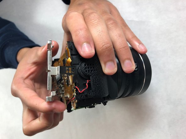

  11. Fujifilm FinePix S4200 Lens Replacement: crwdns2935265:011crwdnd2935265:01crwdnd2935265:01crwdne2935265:0
    • Remove the motherboard. It should be free of all connections at this point and can be lifted with ease.
