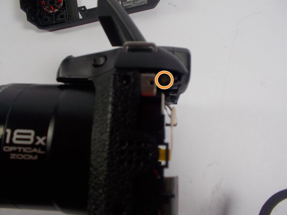

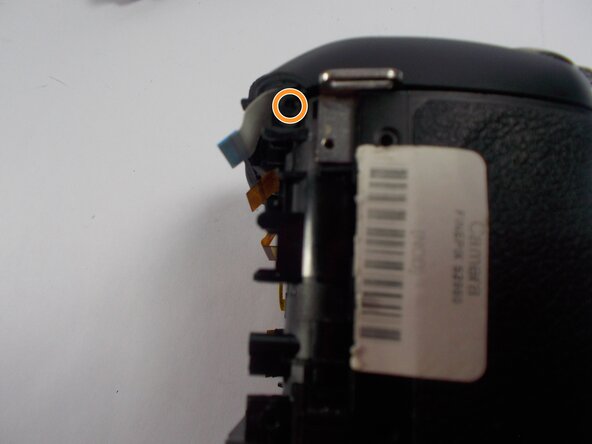

    • Remove the two screws from underneath the flash mechanism.
    • Remove the two screws placed on the right and left sides of the camera.

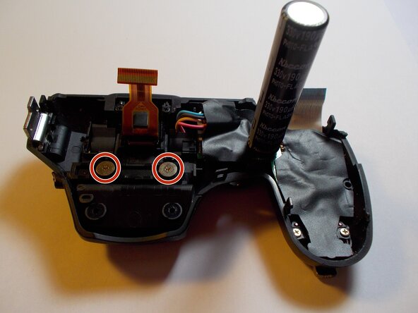

    • Remove two silver plated screw from under the top of the camera, under the flash.
