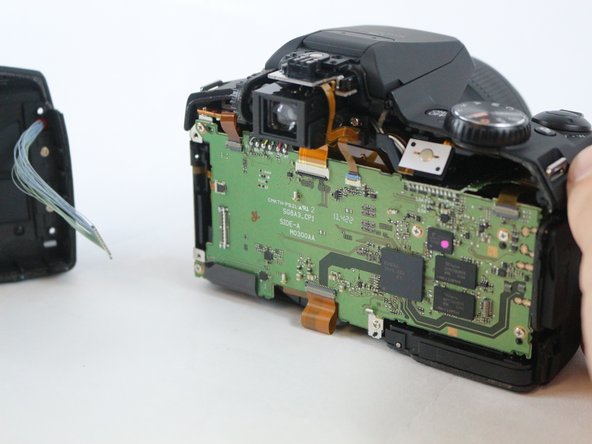

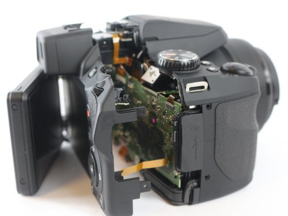

    • Pry apart the back body from the rest of the camera.
  8. Fujifilm FinePix S1 EVF/LCD Button Replacement: crwdns2935265:08crwdnd2935265:01crwdnd2935265:02crwdne2935265:0 Fujifilm FinePix S1 EVF/LCD Button Replacement: crwdns2935265:08crwdnd2935265:02crwdnd2935265:02crwdne2935265:0
    • Carefully pull the back body off of the camera.
    • Make sure to not yank off the connections from the body to the motherboard.

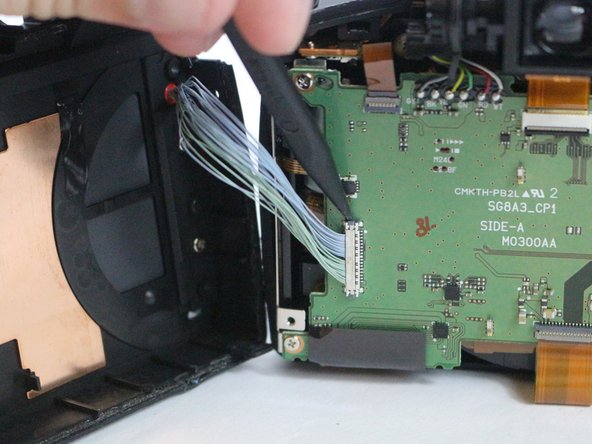

  9. Fujifilm FinePix S1 EVF/LCD Button Replacement: crwdns2935265:09crwdnd2935265:01crwdnd2935265:03crwdne2935265:0 Fujifilm FinePix S1 EVF/LCD Button Replacement: crwdns2935265:09crwdnd2935265:02crwdnd2935265:03crwdne2935265:0 Fujifilm FinePix S1 EVF/LCD Button Replacement: crwdns2935265:09crwdnd2935265:03crwdnd2935265:03crwdne2935265:0
    • Use a spudger to lift up on the tab, releasing the yellow wire strip.
    • Use a spudger to lift up on the side tab, releasing the blue wire connection.

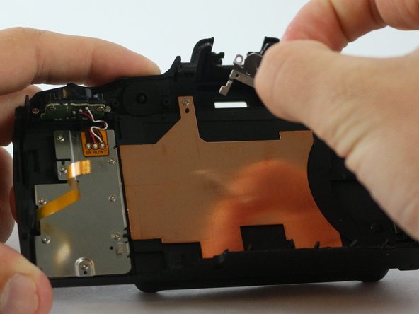

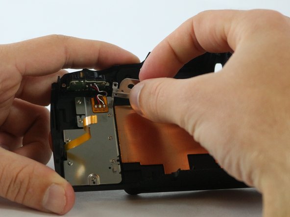

  10. Fujifilm FinePix S1 EVF/LCD Button Replacement, EVF/LCD Button Cover: crwdns2935265:010crwdnd2935265:01crwdnd2935265:01crwdne2935265:0
    • Remove 2 screws from back of EVF/LCD button.
  11. Fujifilm FinePix S1 EVF/LCD Button Replacement: crwdns2935265:011crwdnd2935265:01crwdnd2935265:03crwdne2935265:0 Fujifilm FinePix S1 EVF/LCD Button Replacement: crwdns2935265:011crwdnd2935265:02crwdnd2935265:03crwdne2935265:0 Fujifilm FinePix S1 EVF/LCD Button Replacement: crwdns2935265:011crwdnd2935265:03crwdnd2935265:03crwdne2935265:0
    • Pull EVF/LCD button frame out from the camera casing.
  12. Fujifilm FinePix S1 EVF/LCD Button Replacement: crwdns2935265:012crwdnd2935265:01crwdnd2935265:03crwdne2935265:0 Fujifilm FinePix S1 EVF/LCD Button Replacement: crwdns2935265:012crwdnd2935265:02crwdnd2935265:03crwdne2935265:0 Fujifilm FinePix S1 EVF/LCD Button Replacement: crwdns2935265:012crwdnd2935265:03crwdnd2935265:03crwdne2935265:0
    • Pull button cover off of the button frame.
