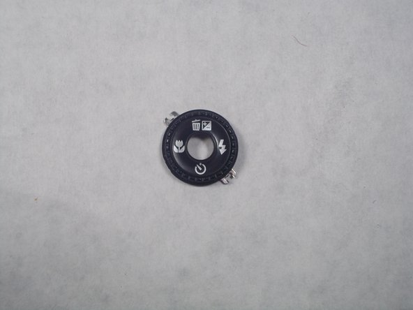

  8. Fujifilm FinePix F505EXR Selector Button Replacement, Selector Button: crwdns2935265:09crwdnd2935265:01crwdnd2935265:01crwdne2935265:0
    • After the selector button circuit board is taken out. There will be a black rubber display for the front buttons, remove this.
  9. Fujifilm FinePix F505EXR Selector Button Replacement: crwdns2935265:010crwdnd2935265:01crwdnd2935265:02crwdne2935265:0 Fujifilm FinePix F505EXR Selector Button Replacement: crwdns2935265:010crwdnd2935265:02crwdnd2935265:02crwdne2935265:0
    • After taking the rubber button selector out, there will still be a circular metal selector button. This is what makes the camera delete pictures and do various tasks. Remove this and set aside.
  10. Fujifilm FinePix F505EXR Selector Button Replacement: crwdns2935265:011crwdnd2935265:01crwdnd2935265:01crwdne2935265:0
    • Finally replace the selector button with the new replacement.
