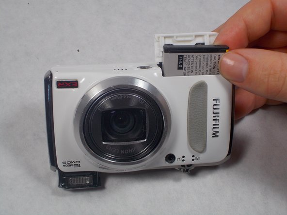

    • Power the device down before taking any other actions.
    • Hold the camera with the lens facing towards youself.
    • Turn the camera upside down and place your right thumb on the battery chamber cover.
  2. Fujifilm FinePix F505EXR Mode Dial Replacement: crwdns2935265:02crwdnd2935265:01crwdnd2935265:02crwdne2935265:0 Fujifilm FinePix F505EXR Mode Dial Replacement: crwdns2935265:02crwdnd2935265:02crwdnd2935265:02crwdne2935265:0
    • Hold the camera, then pull the battery chamber towards yourself with your right thumb.
    • Pull the cover entirely out and release it to reveal the battery.
  3. Fujifilm FinePix F505EXR Mode Dial Replacement: crwdns2935265:03crwdnd2935265:01crwdnd2935265:02crwdne2935265:0 Fujifilm FinePix F505EXR Mode Dial Replacement: crwdns2935265:03crwdnd2935265:02crwdnd2935265:02crwdne2935265:0
    • Locate the orange battery latch that holds the battery in place.
    • Use your finger to push the latch away from yourself to release the battery.
    • Remove the battery manually from the battery chamber.
    • Place the battery into a charger if it is dead.
    • Remove battery before performing any other repairs.
    • Replace defective battery if previous steps fail
    • Contact support on the Fujifilm website for further assistance

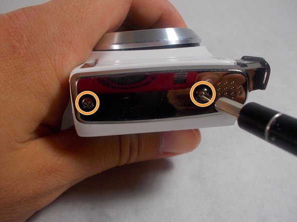

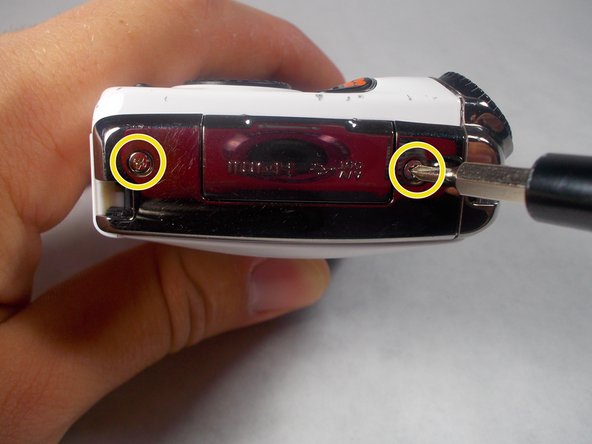

    • Remove four 2.5mm Phillips #1 screws on the bottom of the camera near where the camera mount attaches.
    • Remove two 5.1mm Phillips #1 screws on the left side of the camera relative to the LCD screen.
    • Remove two 5.1mm Phillips #1 screws on the right side of the camera relative to the LCD screen nearest to the mode wheel.

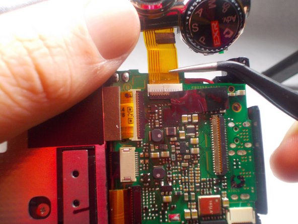

  5. Fujifilm FinePix F505EXR Mode Dial Replacement: crwdns2935265:06crwdnd2935265:01crwdnd2935265:02crwdne2935265:0 Fujifilm FinePix F505EXR Mode Dial Replacement: crwdns2935265:06crwdnd2935265:02crwdnd2935265:02crwdne2935265:0
    • Place the camera lens face down with the LCD screen face up on a flat surface, or hold it. Carefully lift the camera’s back cover approximately 1 inch.
    • Carefully lift the ribbon clamp connector back using the tweezers and remove the blue ribbon.
    • Do NOT pull on ribbon if the ribbon clamp connector still grasps the blue ribbon. This could cause severe damage to the ribbon.
    • If you are replacing the LCD monitor you can skip steps 6 and 7 for the selector button circuit board guide and go directly to the LCD monitor repair guide.
    • If you are replacing the Mode Dial you can skip steps 6 and 7 for the selector button circuit board guide and go directly to the Mode Dial repair guide.

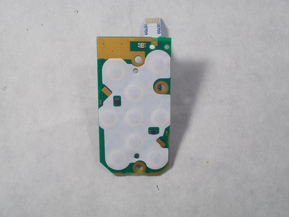

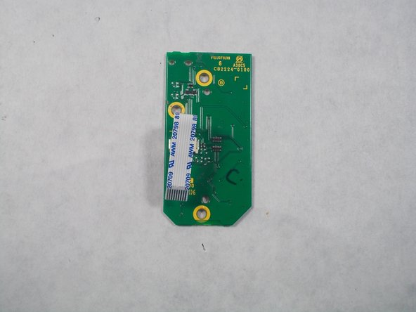

  6. Fujifilm FinePix F505EXR Mode Dial Replacement: crwdns2935265:07crwdnd2935265:01crwdnd2935265:01crwdne2935265:0
    • Remove the back of the camera case and place it on a flat surface with the selector button circuit board facing up.
    • Remove the three 3.5mm Phillips #1 screws located on the chip seen in the image.
  7. Fujifilm FinePix F505EXR Mode Dial Replacement: crwdns2935265:08crwdnd2935265:01crwdnd2935265:03crwdne2935265:0 Fujifilm FinePix F505EXR Mode Dial Replacement: crwdns2935265:08crwdnd2935265:02crwdnd2935265:03crwdne2935265:0 Fujifilm FinePix F505EXR Mode Dial Replacement: crwdns2935265:08crwdnd2935265:03crwdnd2935265:03crwdne2935265:0
    • Lift the chip with tweezers to remove it from the other remaining components.

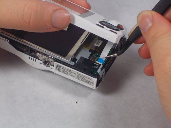

    • With the the camera on a flat surface with the LCD monitor on the surface, lift the front panel of the camera gently up.
  10. Fujifilm FinePix F505EXR Mode Dial Replacement: crwdns2935265:011crwdnd2935265:01crwdnd2935265:02crwdne2935265:0 Fujifilm FinePix F505EXR Mode Dial Replacement: crwdns2935265:011crwdnd2935265:02crwdnd2935265:02crwdne2935265:0
    • Hold the camera like you are going to take a picture, and the top bar should be able to separate from the camera a little bit.
    • Do NOT pull until the top bar comes completely apart from the camera, this can cause serious damage to the camera.
    • With the tweezers remove the ribbon cable from its clip to completely separate the top bar from the camera.

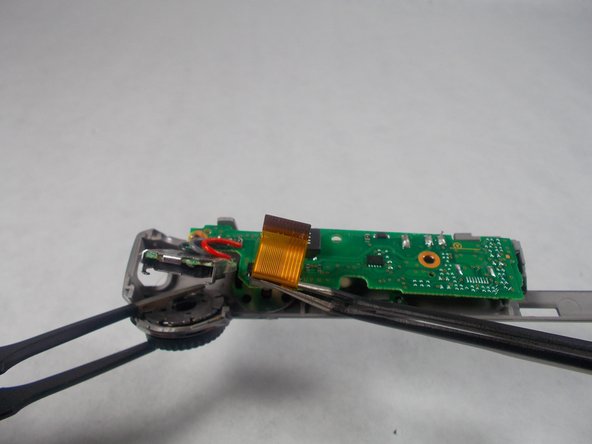

  11. Fujifilm FinePix F505EXR Mode Dial Replacement: crwdns2935265:012crwdnd2935265:01crwdnd2935265:02crwdne2935265:0 Fujifilm FinePix F505EXR Mode Dial Replacement: crwdns2935265:012crwdnd2935265:02crwdnd2935265:02crwdne2935265:0
    • Flip the top bar over and remove the two 3.2 mm Phillips #1 screws to release the circuit board.
    • With the tweezers remove the circuit board to expose the Mode Dial configuration.

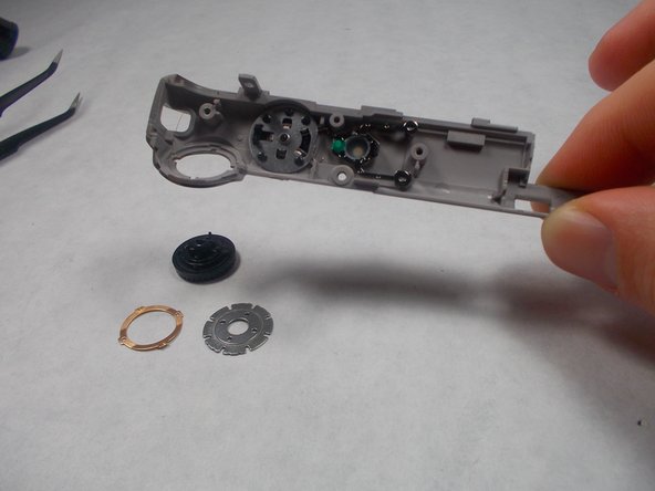

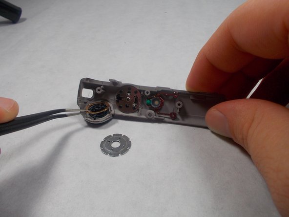

  12. Fujifilm FinePix F505EXR Mode Dial Replacement: crwdns2935265:013crwdnd2935265:01crwdnd2935265:03crwdne2935265:0 Fujifilm FinePix F505EXR Mode Dial Replacement: crwdns2935265:013crwdnd2935265:02crwdnd2935265:03crwdne2935265:0 Fujifilm FinePix F505EXR Mode Dial Replacement: crwdns2935265:013crwdnd2935265:03crwdnd2935265:03crwdne2935265:0
    • With the tweezers remove the chrome circle piece.
    • Next, remove the gold circle piece, this will allow you to pick up the top bar and release the Mode Dial.
