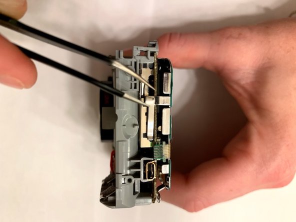

    • Use a #00 Phillips screwdriver to remove all six screws around the camera that is holding the case.
  2. Fujifilm FinePix AX665 Lens Housing Replacement: crwdns2935265:02crwdnd2935265:01crwdnd2935265:03crwdne2935265:0 Fujifilm FinePix AX665 Lens Housing Replacement: crwdns2935265:02crwdnd2935265:02crwdnd2935265:03crwdne2935265:0 Fujifilm FinePix AX665 Lens Housing Replacement: crwdns2935265:02crwdnd2935265:03crwdnd2935265:03crwdne2935265:0
    • Use a plastic pick to separate each side of the camera case apart.

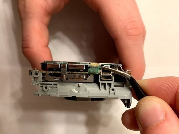

  4. Fujifilm FinePix AX665 Lens Housing Replacement: crwdns2935265:04crwdnd2935265:01crwdnd2935265:02crwdne2935265:0 Fujifilm FinePix AX665 Lens Housing Replacement: crwdns2935265:04crwdnd2935265:02crwdnd2935265:02crwdne2935265:0
    • Remove the four metal clips around the camera until you can feel the metal bracket that holds the screen pop off.

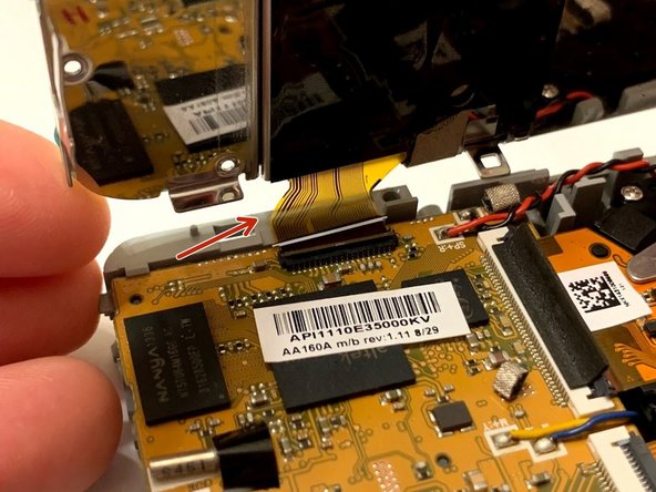

  5. Fujifilm FinePix AX665 Lens Housing Replacement: crwdns2935265:05crwdnd2935265:01crwdnd2935265:02crwdne2935265:0 Fujifilm FinePix AX665 Lens Housing Replacement: crwdns2935265:05crwdnd2935265:02crwdnd2935265:02crwdne2935265:0
    • Carefully flip the screen and remove the ribbon cable attaching it to the logic board.
