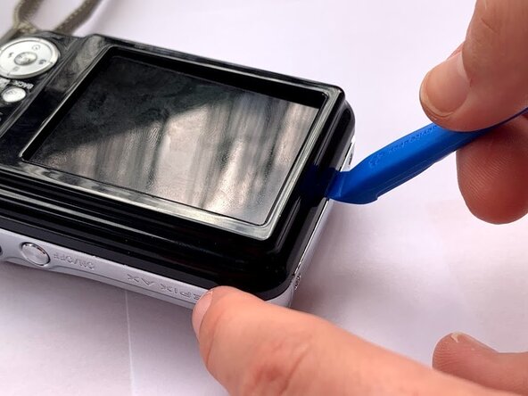

    • Use a plastic pick to separate each side of the camera case apart

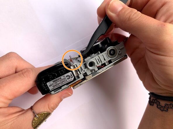

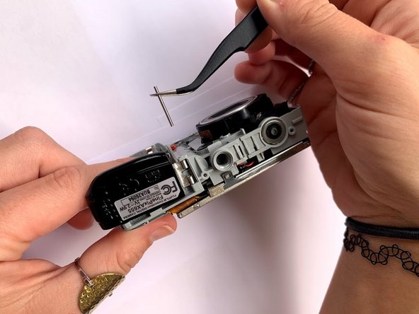

    • Put the tweezers in one end where the bar that connects the battery door to the body of the camera so that the end of the bar sticks out.
    • Remove this metal bar and replace with new one if damaged
