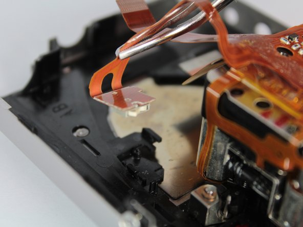

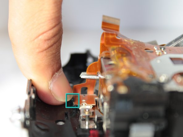

  12. Fujifilm FinePix 4700 Zoom Lens Replacement, Lens: crwdns2935265:012crwdnd2935265:01crwdnd2935265:03crwdne2935265:0 Fujifilm FinePix 4700 Zoom Lens Replacement, Lens: crwdns2935265:012crwdnd2935265:02crwdnd2935265:03crwdne2935265:0 Fujifilm FinePix 4700 Zoom Lens Replacement, Lens: crwdns2935265:012crwdnd2935265:03crwdnd2935265:03crwdne2935265:0
    • Use the spudger to push in the white tab on the square circuit board attached to the front case.
    • Use your finger to pull back the black plastic mount on the right side of the circuit board.
    • While holding back the black plastic mount, use the tweezers to gently lift the ribbon attached to the circuit board.
    • The ribbon and circuit board should both detach from the front case.

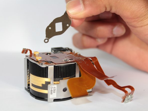

    • Use the Phillips #00 screwdriver to remove the two 4.4mm screws holding the metal bracket on the lens.
    • Use your fingers to remove the bracket.
  15. Fujifilm FinePix 4700 Zoom Lens Replacement: crwdns2935265:015crwdnd2935265:01crwdnd2935265:01crwdne2935265:0
    • Use the tweezers to lift the orange plastic plate from the upper left hand corner.
