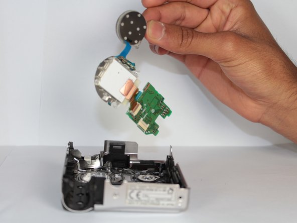

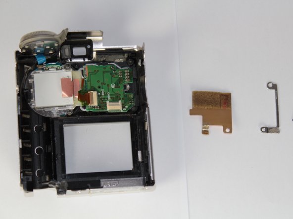

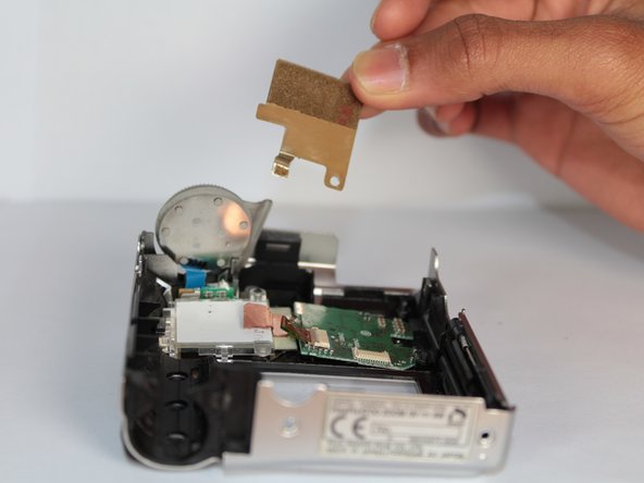

  7. Fujifilm FinePix 4700 Zoom Button Circuit Board Replacement: crwdns2935265:07crwdnd2935265:01crwdnd2935265:03crwdne2935265:0 Fujifilm FinePix 4700 Zoom Button Circuit Board Replacement: crwdns2935265:07crwdnd2935265:02crwdnd2935265:03crwdne2935265:0 Fujifilm FinePix 4700 Zoom Button Circuit Board Replacement: crwdns2935265:07crwdnd2935265:03crwdnd2935265:03crwdne2935265:0
    • Use your fingers to remove the metal bracket and brown colored film.

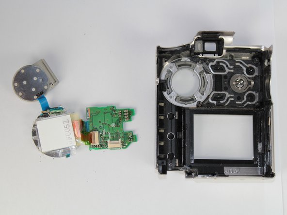

  8. Fujifilm FinePix 4700 Zoom Button Circuit Board Replacement: crwdns2935265:08crwdnd2935265:01crwdnd2935265:03crwdne2935265:0 Fujifilm FinePix 4700 Zoom Button Circuit Board Replacement: crwdns2935265:08crwdnd2935265:02crwdnd2935265:03crwdne2935265:0 Fujifilm FinePix 4700 Zoom Button Circuit Board Replacement: crwdns2935265:08crwdnd2935265:03crwdnd2935265:03crwdne2935265:0
    • Use the spudger to pry up the clear plastic tab.
    • Pull the button receiver, button circuit board, and swivel button out as a single unit.
    • Jiggle the swivel button out of place if necessary.
