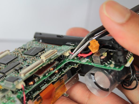

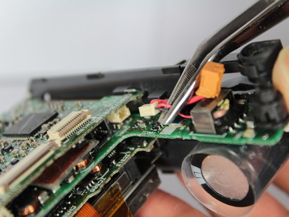

  12. Fujifilm FinePix 4700 Zoom Battery Compartment Replacement, Battery Compartment: crwdns2935265:012crwdnd2935265:01crwdnd2935265:01crwdne2935265:0
    • Locate the wires running from the battery compartment to the main motherboard.
    • There are two sets of black and red wires.
  13. Fujifilm FinePix 4700 Zoom Battery Compartment Replacement: crwdns2935265:013crwdnd2935265:01crwdnd2935265:03crwdne2935265:0 Fujifilm FinePix 4700 Zoom Battery Compartment Replacement: crwdns2935265:013crwdnd2935265:02crwdnd2935265:03crwdne2935265:0 Fujifilm FinePix 4700 Zoom Battery Compartment Replacement: crwdns2935265:013crwdnd2935265:03crwdnd2935265:03crwdne2935265:0
    • Use the tweezers to grab one set of wires near where it connects to the motherboard.
    • Pull the set of wires straight out.
    • Repeat these steps for the other set of wires.

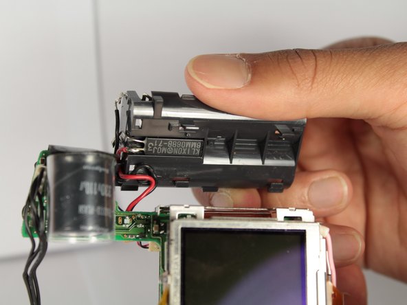

  14. Fujifilm FinePix 4700 Zoom Battery Compartment Replacement: crwdns2935265:014crwdnd2935265:01crwdnd2935265:03crwdne2935265:0 Fujifilm FinePix 4700 Zoom Battery Compartment Replacement: crwdns2935265:014crwdnd2935265:02crwdnd2935265:03crwdne2935265:0 Fujifilm FinePix 4700 Zoom Battery Compartment Replacement: crwdns2935265:014crwdnd2935265:03crwdnd2935265:03crwdne2935265:0
    • Lift and pull outward (at the same time) the two battery clips that are next to the screen.
    • The battery compartment should now be detached from the rest of the motherboard unit.
