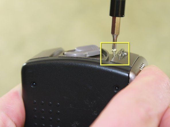

    • Locate and remove the 6.4mm screws located on either side of the camera with a Phillips #00 screwdriver.

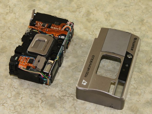

  8. Fujifilm Endeavor 100ix Film Door Replacement: crwdns2935265:08crwdnd2935265:01crwdnd2935265:01crwdne2935265:0
    • Insert the flat edge of the spudger between the gold front casing and the black back casing.
    • Pry the spudger upward until the black back casing snaps out and is dislodged on that edge of the camera.
  9. Fujifilm Endeavor 100ix Film Door Replacement: crwdns2935265:09crwdnd2935265:01crwdnd2935265:01crwdne2935265:0
    • Squeeze the camera by placing a thumb on the tab marked CE.
    • Pull the back half of the camera firmly away from the camera body.

    • Pull the front cover off of the camera by lifting the tripod tab over the tripod hole.
