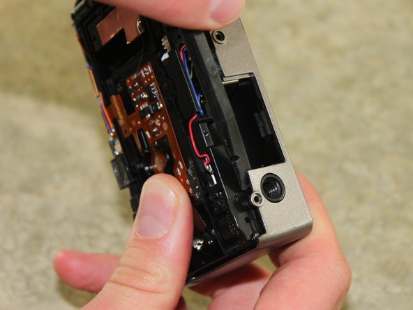

    • Locate and remove two 6.4mm screws on the bottom of the camera with a Phillips #00 screwdriver.
  2. Fujifilm Endeavor 100ix Battery Door Replacement: crwdns2935265:02crwdnd2935265:01crwdnd2935265:01crwdne2935265:0
    • Locate the battery door.
  3. Fujifilm Endeavor 100ix Battery Door Replacement: crwdns2935265:03crwdnd2935265:01crwdnd2935265:01crwdne2935265:0
    • Locate the latch on the battery door.
    • Use your finger pry to it open where it says "BATT."
  4. Fujifilm Endeavor 100ix Battery Door Replacement: crwdns2935265:04crwdnd2935265:01crwdnd2935265:01crwdne2935265:0
    • Remove the battery from the camera by pulling the battery door outward.
  5. Fujifilm Endeavor 100ix Battery Door Replacement: crwdns2935265:05crwdnd2935265:01crwdnd2935265:01crwdne2935265:0
    • Locate and remove three black 3.80mm screws on the back of the black casing with the Phillips #00 screwdriver.
  6. Fujifilm Endeavor 100ix Battery Door Replacement: crwdns2935265:06crwdnd2935265:01crwdnd2935265:01crwdne2935265:0
    • Squeeze the camera placing a thumb on the tab marked CE.
    • Pull the back half of the camera firmly away from the camera body.
  7. Fujifilm Endeavor 100ix Battery Door Replacement: crwdns2935265:07crwdnd2935265:01crwdnd2935265:02crwdne2935265:0 Fujifilm Endeavor 100ix Battery Door Replacement: crwdns2935265:07crwdnd2935265:02crwdnd2935265:02crwdne2935265:0
    • Locate and remove the 3.80mm screw that holds the plastic strip to the camera body with a Phillips #00 screwdriver.
    • The plastic strip will now come off the camera body.
