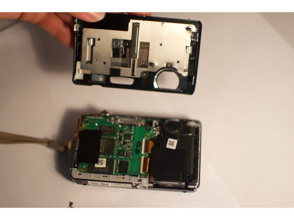

    • Use a small #000 Phillips screwdriver to take the screws out. Keep all the screws in a container and the two different types separate.
    • Remove the two screws on the right side.On the same side there is USB connector, open that little door and unscrew the little screw inside of it.
  2. Fujifilm  FinePix Z90 Lens cover/case Replacement: crwdns2935265:02crwdnd2935265:01crwdnd2935265:02crwdne2935265:0 Fujifilm  FinePix Z90 Lens cover/case Replacement: crwdns2935265:02crwdnd2935265:02crwdnd2935265:02crwdne2935265:0
    • Take the two screws on the left side and the two screws on the bottom of the camera.
  3. Fujifilm  FinePix Z90 Lens cover/case Replacement: crwdns2935265:03crwdnd2935265:01crwdnd2935265:02crwdne2935265:0 Fujifilm  FinePix Z90 Lens cover/case Replacement: crwdns2935265:03crwdnd2935265:02crwdnd2935265:02crwdne2935265:0
    • By now you will have the front case and the back case separated from each other.
