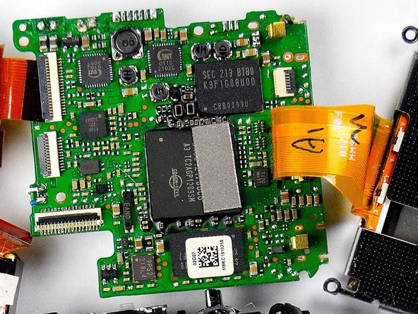

    1. FujiFilm FinePix XP50 Motherboard  Replacement, Motherboard: crwdns2935265:07crwdnd2935265:01crwdnd2935265:01crwdne2935265:0
      • Using Phillips #00 screwdriver, remove four 3.0 mm screws holding motherboard in place.
    2. FujiFilm FinePix XP50 Motherboard  Replacement: crwdns2935265:08crwdnd2935265:01crwdnd2935265:01crwdne2935265:0
      • Insert the spudger in between the side case pannel and the motherboard.
      • Move the spudger in an upward motion to pry the motherboard out of the plastic housing. Work all the way around the motherboard until the motherboard is free.
    3. FujiFilm FinePix XP50 Motherboard  Replacement: crwdns2935265:09crwdnd2935265:01crwdnd2935265:02crwdne2935265:0 FujiFilm FinePix XP50 Motherboard  Replacement: crwdns2935265:09crwdnd2935265:02crwdnd2935265:02crwdne2935265:0
      • There are four wires that are soldered to the motherboard. Detach these wires from the motherboard by desoldering them.This will free the motherboard.
      • For instructions on desoldering see How To Solder and Desolder Connections
