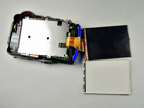

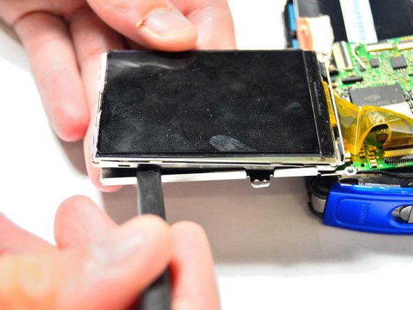

  7. FujiFilm FinePix XP50 LCD Screen Replacement, LCD Screen: crwdns2935265:07crwdnd2935265:01crwdnd2935265:03crwdne2935265:0 FujiFilm FinePix XP50 LCD Screen Replacement, LCD Screen: crwdns2935265:07crwdnd2935265:02crwdnd2935265:03crwdne2935265:0 FujiFilm FinePix XP50 LCD Screen Replacement, LCD Screen: crwdns2935265:07crwdnd2935265:03crwdnd2935265:03crwdne2935265:0
    • Take the spudger and wedge it in between the screen and the frame.
    • Slowly make your way around the screen with the spudger just enough to separate the screen from the frame.

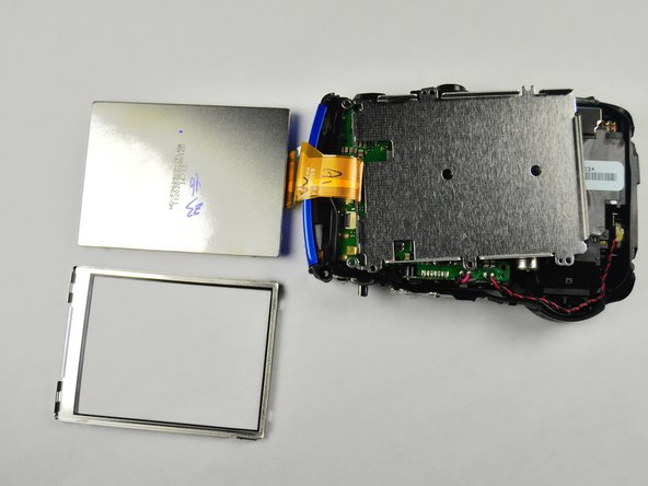

  8. FujiFilm FinePix XP50 LCD Screen Replacement: crwdns2935265:08crwdnd2935265:01crwdnd2935265:02crwdne2935265:0 FujiFilm FinePix XP50 LCD Screen Replacement: crwdns2935265:08crwdnd2935265:02crwdnd2935265:02crwdne2935265:0
    • Take the spudger again and wedge it in the thinner frame to pry the LCD screen from the frame.
    • Make your way around with the spudger just enough to separate the screen and frame once again.
  9. FujiFilm FinePix XP50 LCD Screen Replacement: crwdns2935265:09crwdnd2935265:01crwdnd2935265:02crwdne2935265:0 FujiFilm FinePix XP50 LCD Screen Replacement: crwdns2935265:09crwdnd2935265:02crwdnd2935265:02crwdne2935265:0
    • Take the spudger and wedge it very carefully between the LCD screen and the very thin and fragile frame.
    • Very carefully make your way around the frame with the spudger, while making sure not to use too much force. Otherwise the screen will be damaged.

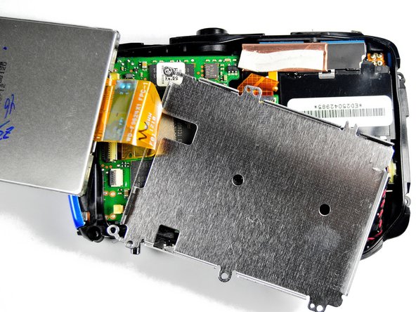

  10. FujiFilm FinePix XP50 LCD Screen Replacement: crwdns2935265:010crwdnd2935265:01crwdnd2935265:01crwdne2935265:0
    • Detach the LCD screen from the motherboard by detaching the orange ribbon.
